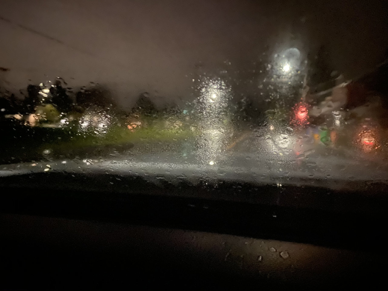

    Dealer says they have no idea why it has condensation on front window. Claimed that parking in driveway that has incline is not allowing possible drainage. It does it intermittently but when it does it it’s a lot.
    had a leak in floorboard they said the fixed and sealed, but still get it. Been to dealer many times and get the don’t know what to tell you.

    Does it occur when/after it rains? If so, check the headliner in the rear, just above the sliding window. If it’s wet, your third brake light may have a seal problem. There’s a TSB for that if that’s the case.

    I will have to check that. It’s at the dealer now. It seems to happen when it rains sometimes and other times when it’s dry.
