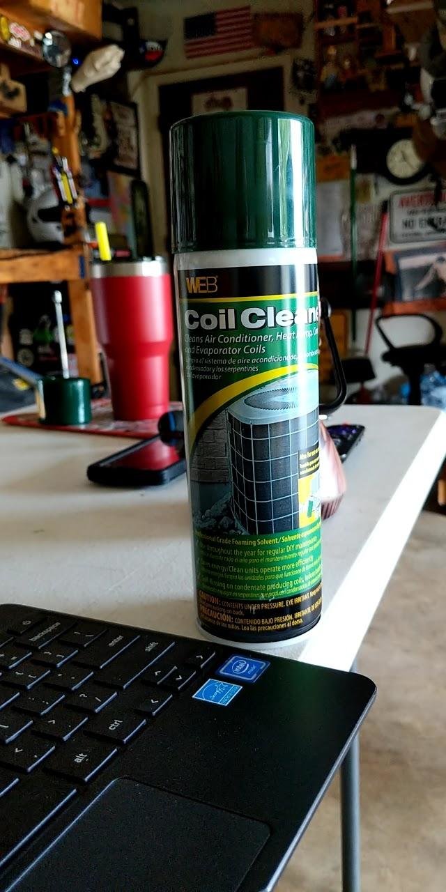

    I use this or similar on my truck and home AC condenser coils at least once a year. I also try to get as much as I can on the radiator fins and the trans cooler too. It says you don't have to rinse, but I do. A lot of bug and other road grime builds up over a short period of time. The first time I used it on my truck it lowered the inside temp by 5° .

    Thanks for the information and picture.
