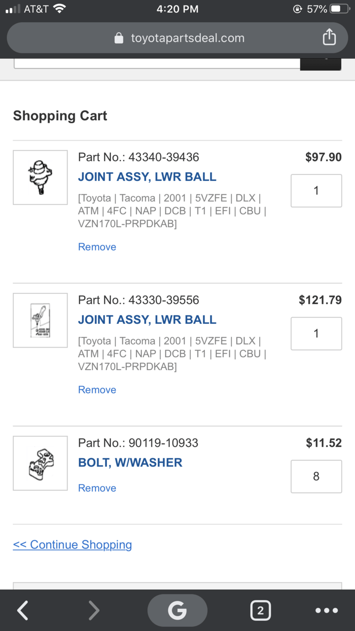

    Sorry to beat a dead horse but wanna confirm these parts. I used my VIN but unsure why they are priced differently? Also are those the correct bolts? Thanks!

    Correct part numbers for LBJs, I have 9010510505 for the bolt part NR. but they may be the same. Try McGeorge toyota parts online, parts are a little cheaper.

    Such conflicting numbers that’s why I’m scratching my head.

    Toyota changed the design a bit and the part numbers in '01.
    '01-'04 trucks came with a little rubber skirt that hung below the BJ to protect the BJ seal from trail rocks and debris. This change changed the part numbers. The '01-'04 part numbers (the ones I listed) do not come with a flanged mounting bolts like earlier models. These newer ones use a bolt with a built in washer.

    There are also different bolt lengths for some BJs. Not entirely sure of the break down, but the ones on my 04 were 2 different lengths.
    Ask me what happens when you aren't paying attention and try to torque down the short bolt where the long bolt should be...:anonymous:
    Luckily, I only tore out a thread or two in the spindle, so I was able to clean up the threads with a tap and got some longer grade 10.9 bolts from Ace hardware.
    Torque to 59 ft-lbs.

    @manesfesto , my best advice, call camelback toyota or McGeorge Toyota and give them your vin #, they should be able to look up the correct part numbers for you.

    Toyotapartsdeal.com can check your vin right on the website. i think other dealers do as well.
