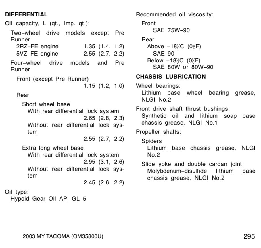

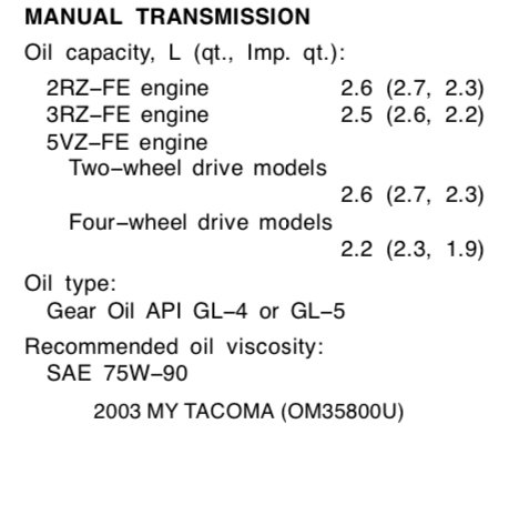

    Got 3 different answers. Dealership, Oreilly’s, da net.
    2003 Tacoma. 22RZ-PE engine. Base cab, manual 2 wheel rear drive. 2.4L. I believe it’s 2.6 qts. for the trans and 1.35 qts. for the differential. I gave Oreilly’s all my vehicle specs and they came up with 2.9 qts. for the diff(?).
    My base cab and year is the only one that uses 75w-90 for both(btw). The trans needs 2.6 qts. I’m pretty sure about that. And the diff needs 1.35 qts.(?).
    So…5 qts. total?
    Using my iphone and the manual print is pretty small.

    According to the manual from the Toyota website.
    I think you have the Quarts and Liters mixed up (but it pretty close either way)
    I get 1.4 for the Diff
    And 2.7 for the Trans
    Liter is BEFORE the “( )”
    Quarts is the 1st one AFTER the “( )”
    C15DDCCB-99A7-40A8-8C6E-D0E4833CAACF.jpg 1AF42357-5CD6-4BAE-BF44-4014A08F1FB6.jpg

    Thanks for reading that small print for me. I’m taking it in to a local good shop for a simple drain and fill of both. I’m figuring 5 qrts. should be enough for them to accomplish the job. I’ll buy one more if you recommend doing so. This one small reputable shop should save me over $100 over other shops for a simple drain and fill. Says I can bring in my own gear oil. Valvaline High Performance. Thanks again for the confirm.

    5 qts. should do it. Technically, you should only need 4.1
    1 extra can’t hurt. Take it back it you need too.
