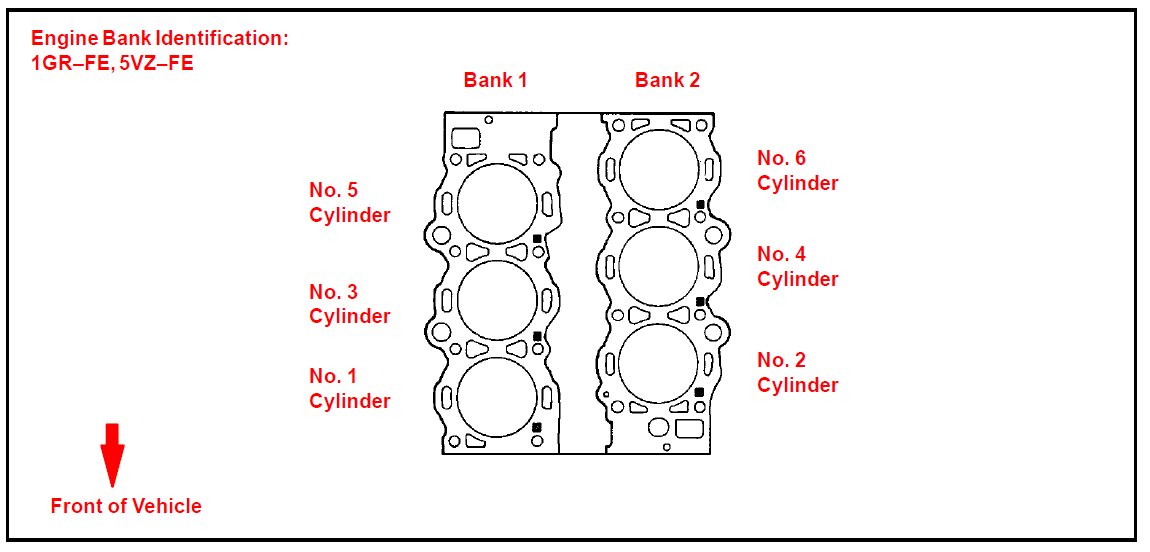

    Just looking for confirmation, bank 1 is the passengers side of the 1GR-FE given the passengers side has the forward most cylinder (Cyls #1, 3, 5) correct?
    Thusly it can be infered that all "bank 1 sensors" would be on the RH (passenger) side of the motor and exhaust system right?
    Second guessing and overthinking myself now. :rolleyes:

    Yes that is correct

    here have you, Bank 1 is passenger, Bank 2 is driver.
