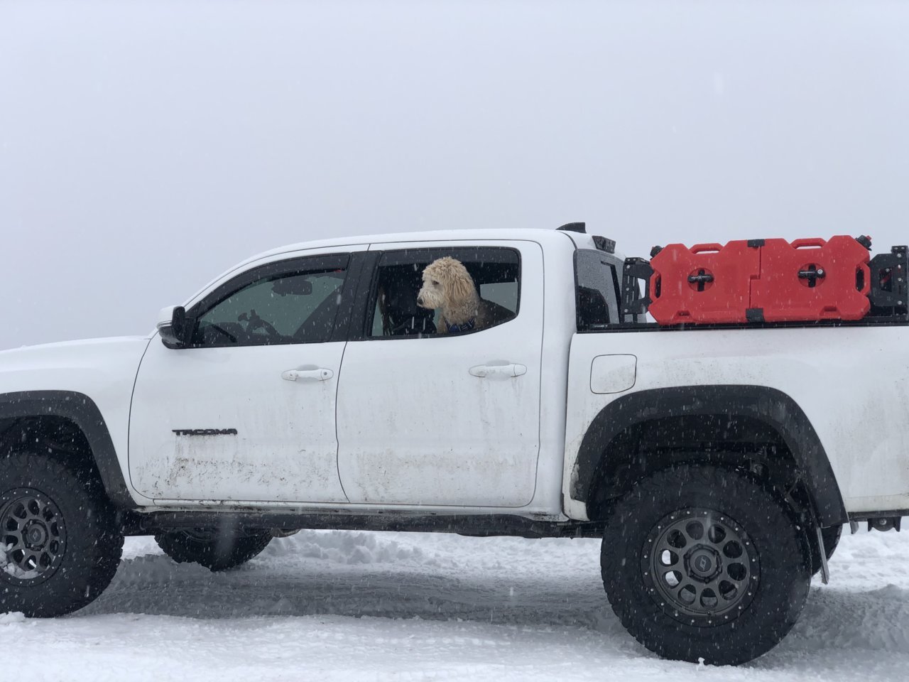

    It’s a great set up. Put mine in around 2k one of the best decisions I have made yet.4AA75377-BF7F-4DB0-8229-51586A8CC25E.jpg
