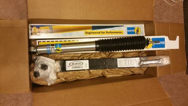

  17. May 6, 2015 at 12:04 PM
    #17
    matt 157
    matt 157 Well-Known Member
    Oct 30, 2014
    #141395
    437
    California
    2003 Black Xtra Cab 4WD SR5 TRD
    Pioneer DEH 8400 head unit/deck, Crunch 1100 watt amp, 12" Kenwood subwoofer, Kicker mids & tweeters, AllPro front tube bumper, Smittybuilt tow hooks, (welded pipe for muffle) straight-pipe, 4 orange "Raptor" lights in grill, Duratrac tires, American Eagle rims, ProComp 2" front leveling kit, Plasi-Dipped black on chrome trim, PIAA fog lights w/ in-cab switch, Unidin CB/Firestik II/8 ohm PA speaker, TRD leather 5-speed shifter knob
    Sorry guys I'm back with a quick question.. So my 884s and 5100s come today but I just realized I can't find any info on people with 1st gens and this setup. I know people run 883s and the 884s are the same just 15mm taller. With my Xtra cab and bumper and v6 are they gonna be fine for a 2" level with the billies set at 0"? If anyone knows for the 1st gens that'd be great. Thanks!
