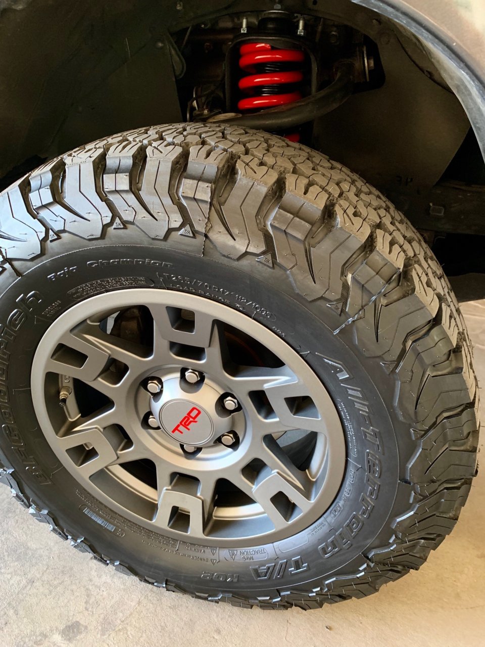

    I recently installed BFG All Terrain KO2 265/70R17 C Load range tires. After much research on this forum and Google searches, answers range from 29 psi to 55 psi.
    My truck doesn't have extra weight added (body armor, etc), I'm trying to keep it light. I also don't tow anything or load the bed very heavy.
    Does anyone have recommendations based on past experience? May number one concern is not wearing out the tires prematurely.
