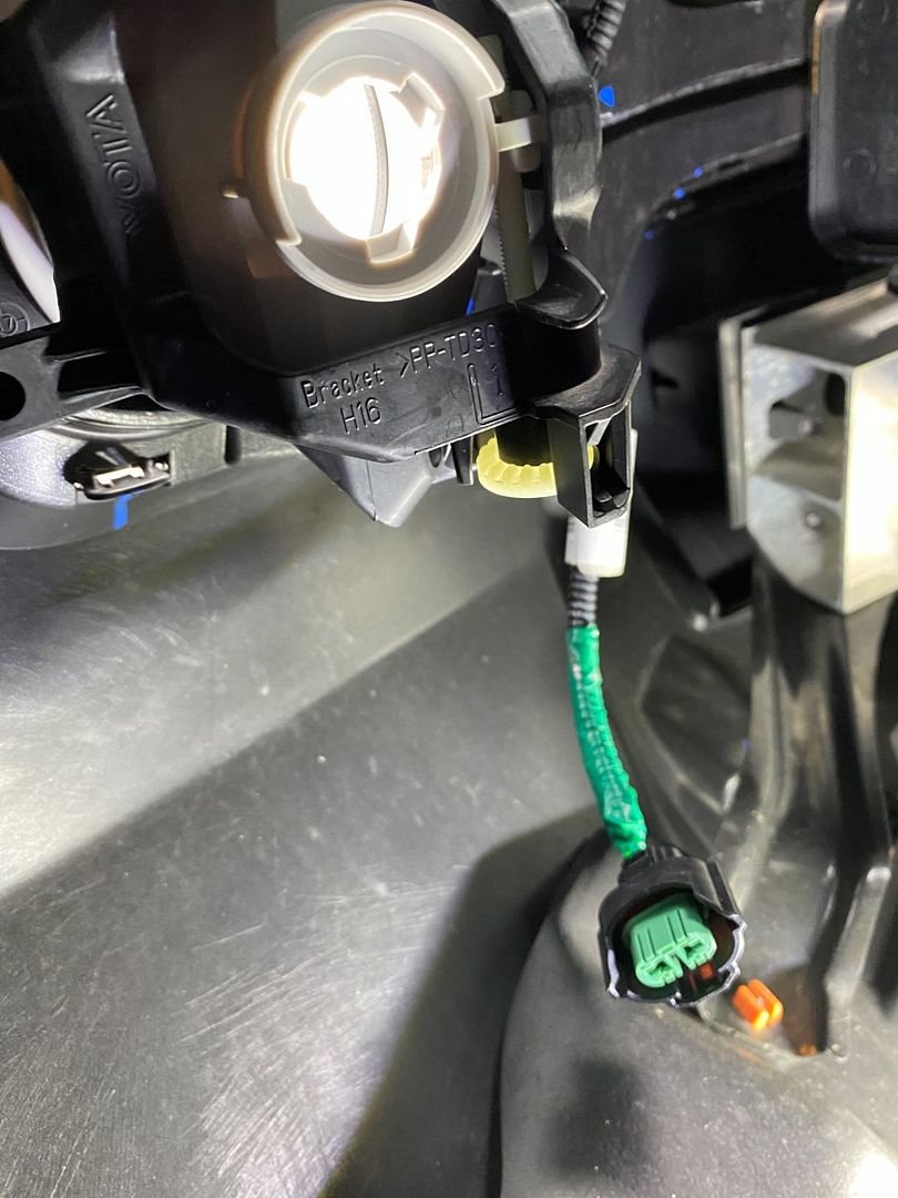

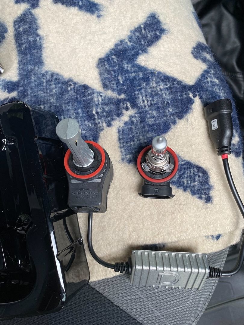

    I went through the side pulling back the plastic underside of wheel-well:
    I didn't have to turn the bulb housing unit. The owner's manual said to disconnect the terminal first.
    So I put it back to the original position and disconnected it.
    Removed the bulb itself.

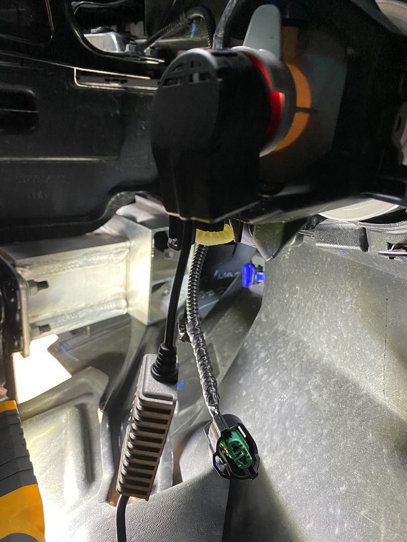

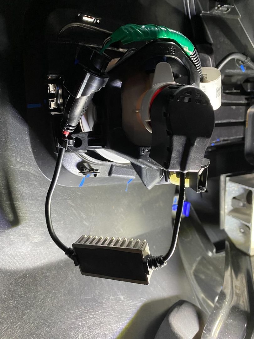

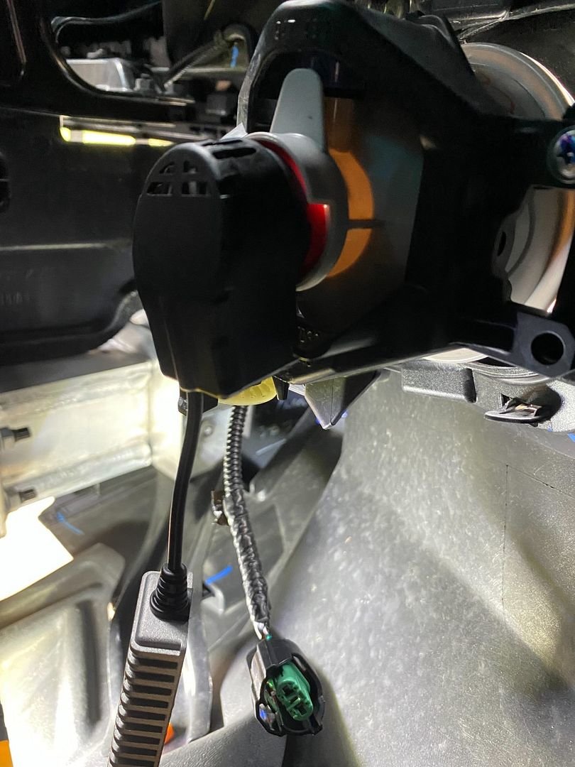

    This was the right side...did my initial learning on that side. Twisted the diode housing in...it took some light turning but nothing too harsh.
    Zip-tie over the top and to the side:
    Looks Good!

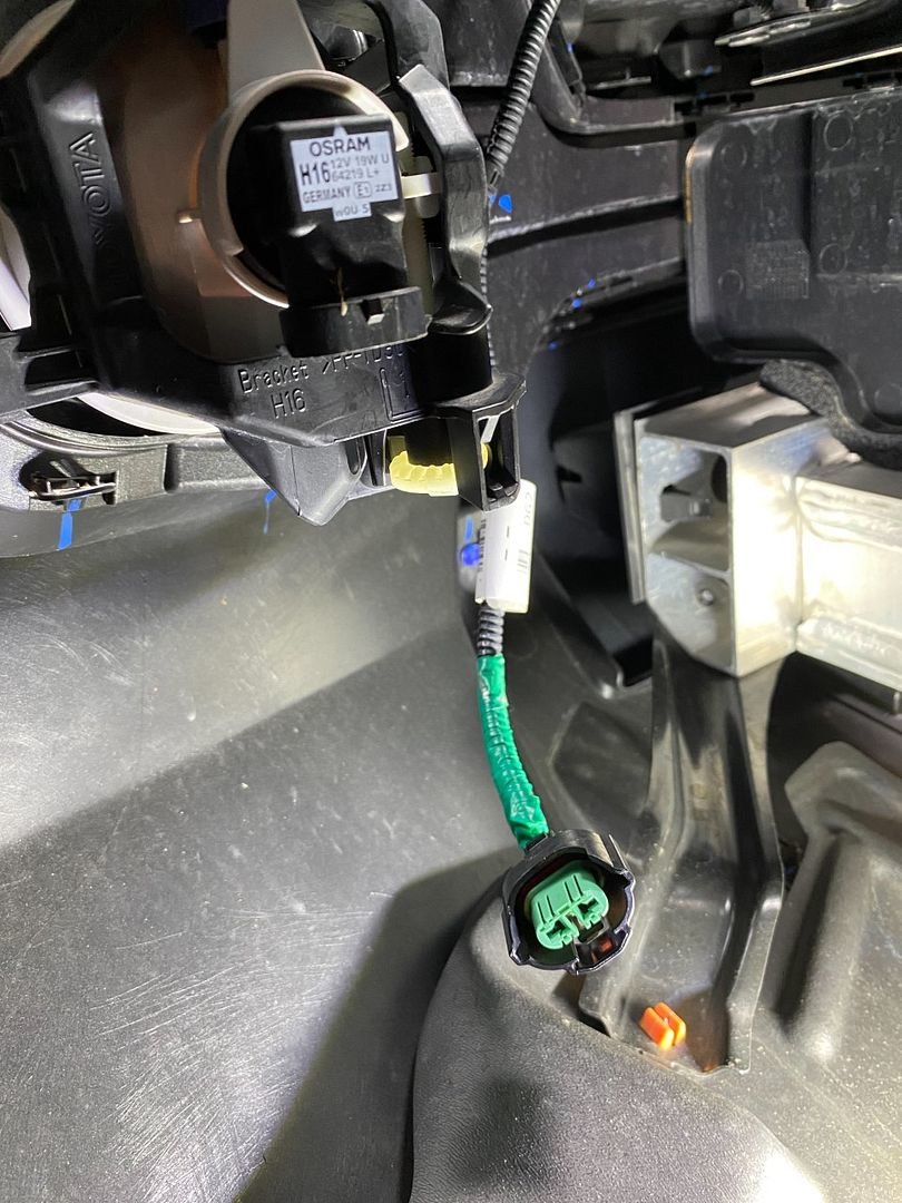

    And a couple of pics of the differences between these two types:
    Ed

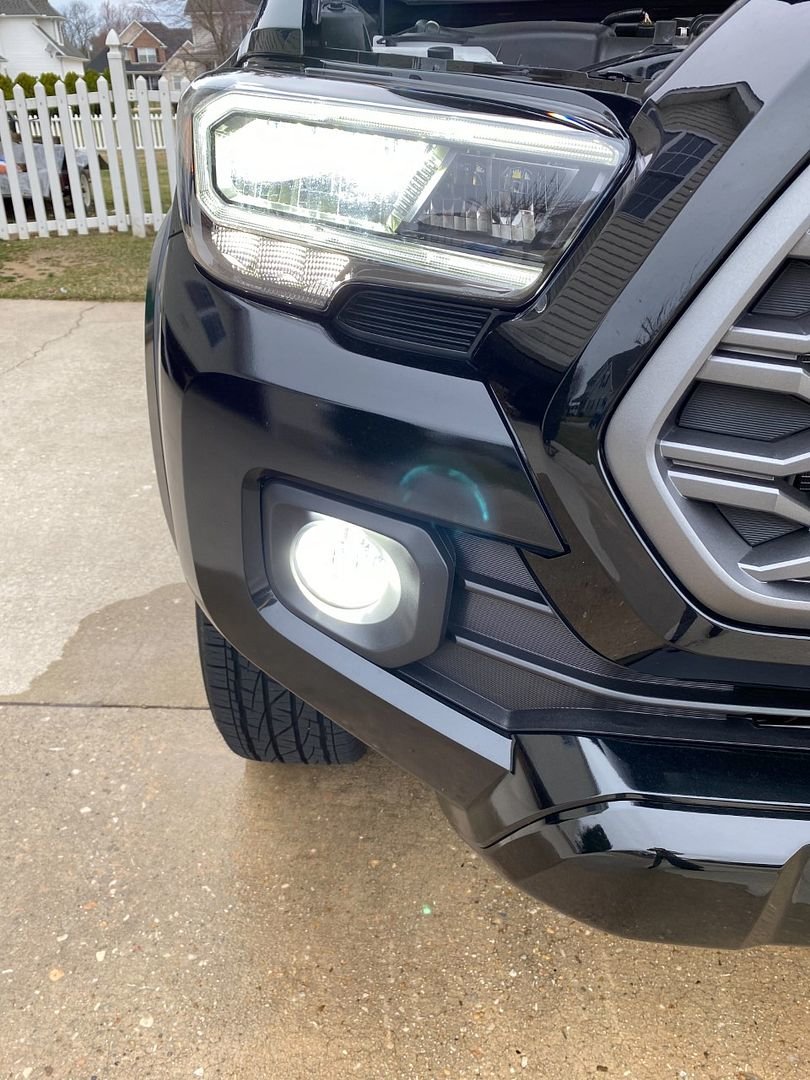

    I'll test them out tonight but by the looks of it, I can already see a huge difference.
