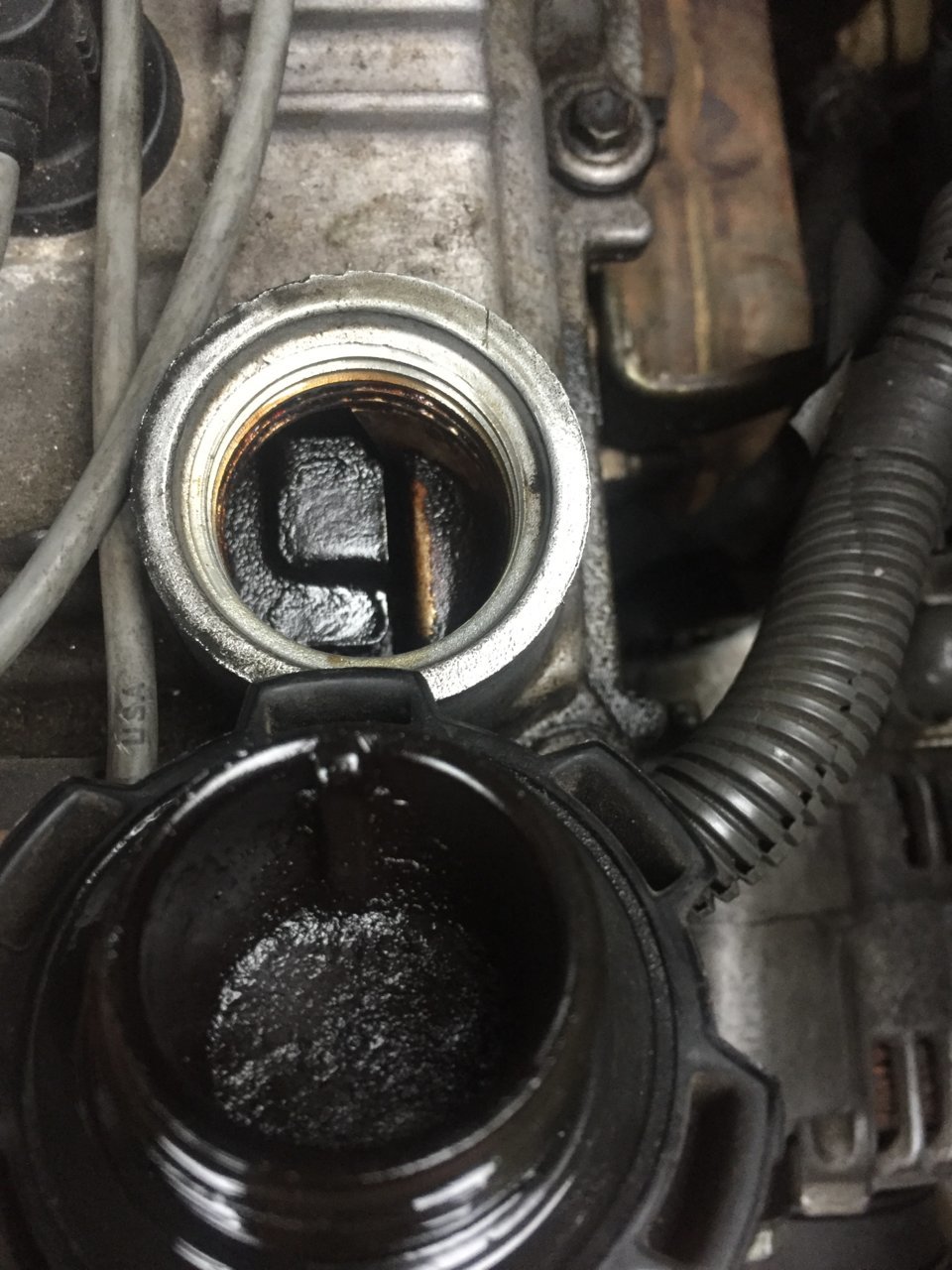

    Can you get a snap of the inside of your oil filler cap?
    fatback803[OP] likes this.

    if you suspect any sludge DO NOT do this. Your pickup screen is going to get clogged

    looks like drive way sealer
    have to wonder what type oil & driving conditions day in/out
    i have doubts ALL the junk yard cures will work as there will e a LOT os detritus
    flowing thru out the engine
    in fact the filter would clog in short if it all were dissolve/broken loose
    if U can SEE that much sludge ............its worse in places cant be seen
    hard to believe the oil pump itself is in shape
    i think the engine has seen ZERO ‘ 0 ‘ oil pressure a few times
    again i say how far will it go after these mentioned junk yard cures

    In this vid I can see that your engine is indeed capable of achieving normal operating temp (I assume the gauge isnt lying and you can actually get heat from your defroster).
    So your deposit issue is likely the result of improper oil change intervals and not a stuck open or missing thermostat. A pan drop would answer some questions but maybe you aren't in such dire straights.
