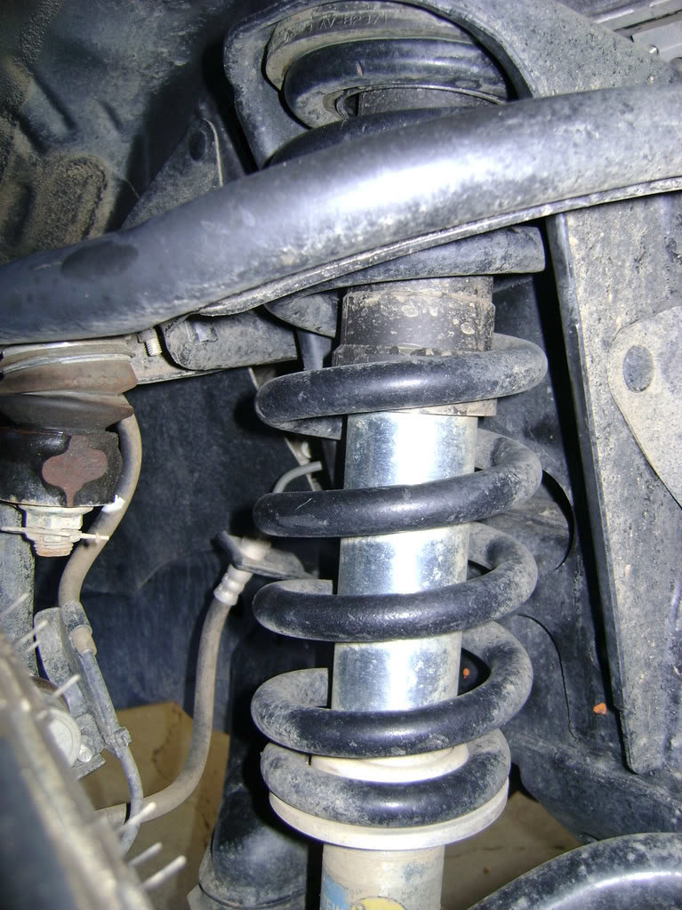

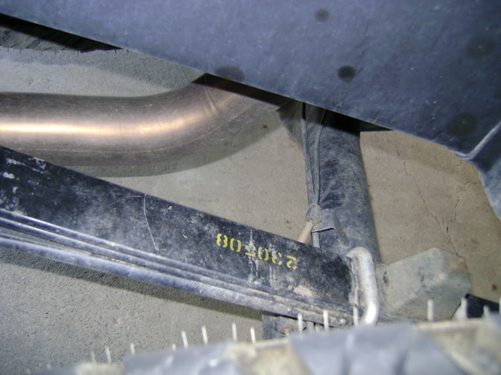

    Post up some pics of your front shocks, and rear springs (near the axel).

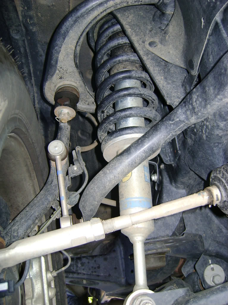

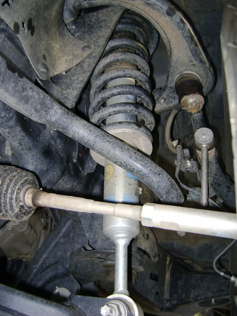

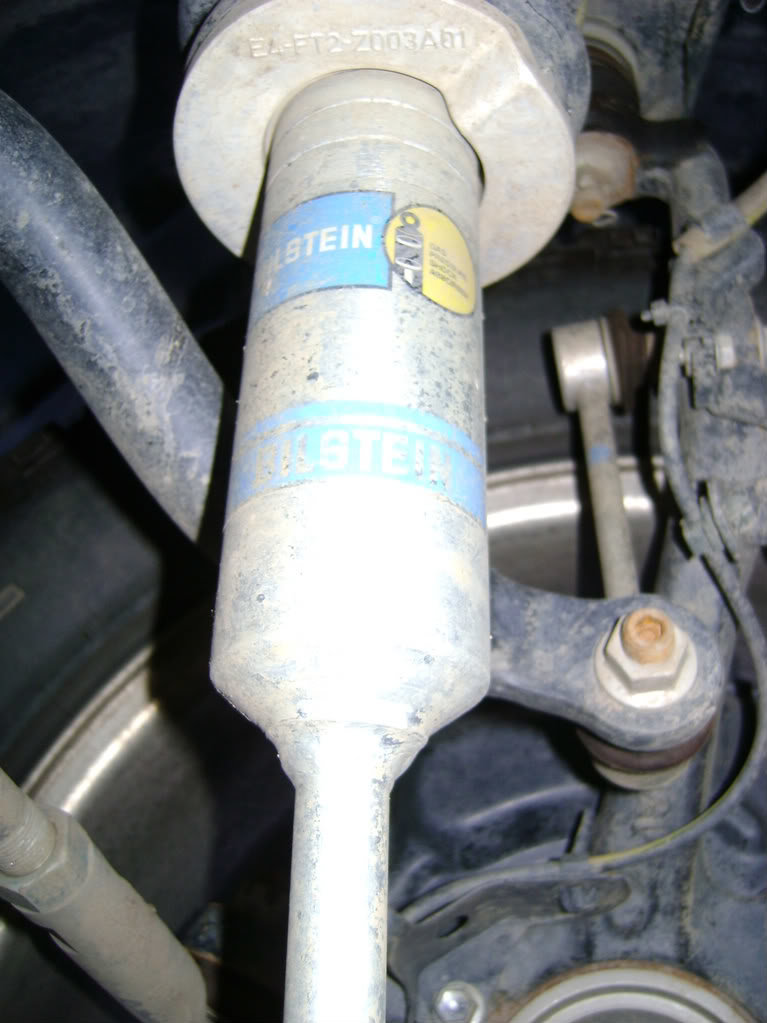

    so im pretty sure i dont have a lift, but my tacomas a couple inches taller then normal tacomas.
    i might have the adujustable 2 inch 5100's
    can anyone help me out?
  5. Jan 14, 2009 at 4:39 PM
    LonghornTaco
    LonghornTaco Can you pass the bailout please?
    Oct 6, 2008
    #9763
    3,326
    Jason
    Minnesota
    Black 09 4x4 TRD Off Road Doublecab
    3" ToyTec coilover lift on Bilstein 5100s, Total Chaos UCAs, ToyTec diff drop, Scangauge II, 4D MagLite mounted on the drivers seat, Painted engine cover, Painted calipers (red), Painted skid plate (red) Valentine 1 radar detector hard wired, Damplifier Pro on the floor, back wall and doors, Luxury Liner Pro on the floor and doors, Kenwood DNX8120, 2 Pioneer TS-SW1041D 10" shallow mount subs, 2 Pioneer PRS-D4200F 1200W amps, Mr Marv sub enclosure, Hybrid Audio Clarus 6.5" components in the front doors, Alpine 5.25" coaxials in the rear doors, A.R.E. LSII fiberglass tonneau cover, All Pro bumper, All Pro sliders, Wet Okole seat covers, Sockmonkey Mountain badges, PIAA 510 SMR Driving Lights, Warn M8000 Winch, Bud Built skids
    Yep, that's the adjustable 5100s and it looks like they're set on the 1.75" setting. That's why your front is taller than normal Tacomas

    ok thanks. so getting the toytec 3 inch lift wouldnt conflict with anything?

    the shocks you have can be adjusted to 2.5" as they are. If you get the OME 3" springs, you would have to have the shocks adjusted down to the lowest setting.

    from the pictures does it look likek their all the way adjusted?
  13. Jan 14, 2009 at 10:16 PM
    LonghornTaco
    Oct 6, 2008
    #9763
    3,326
    Jason
    Minnesota
    It looks to me like it's set at 1.75", so you have one more step up - 2.5"...

    yeah that
