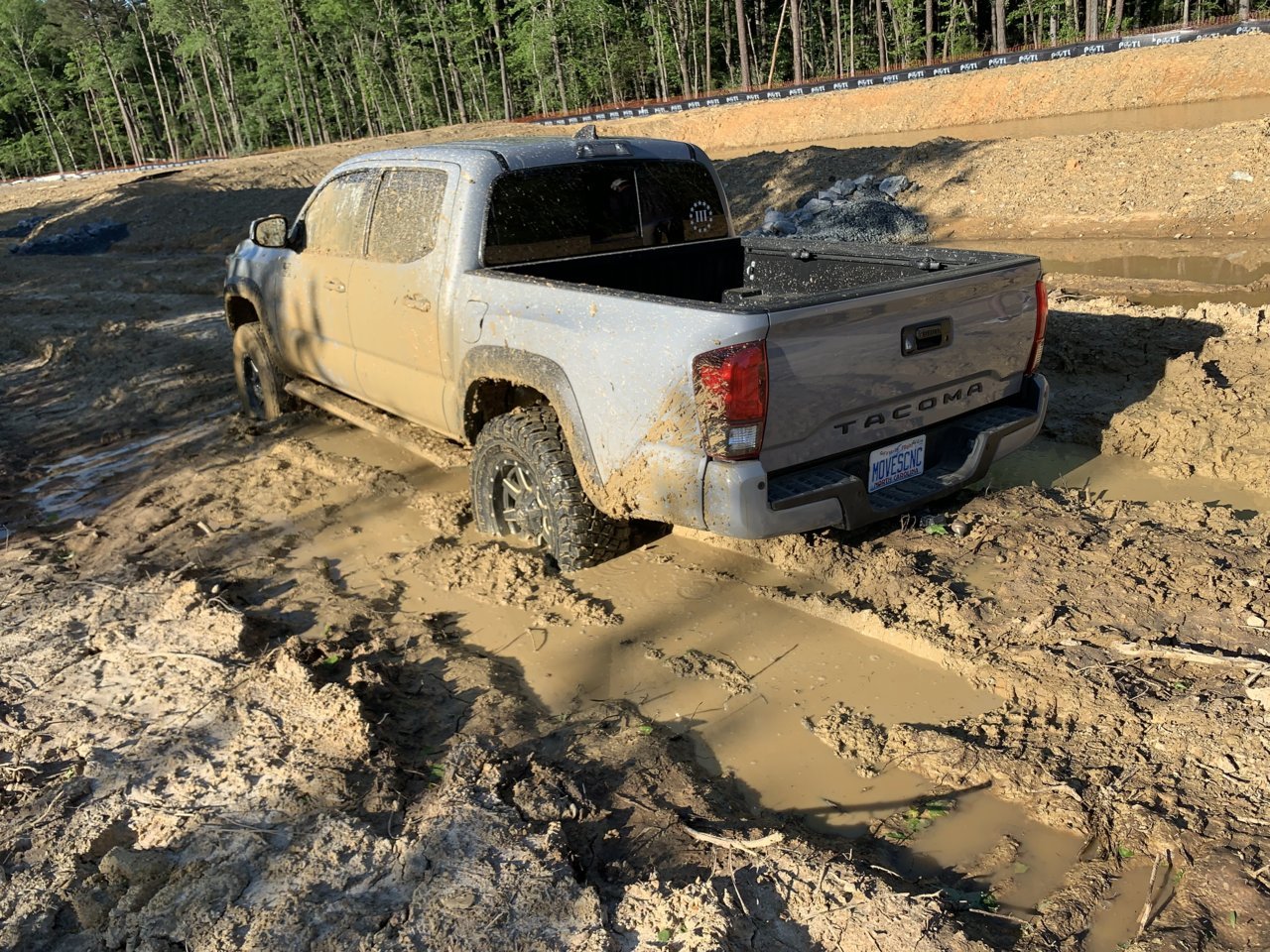

    So I took my truck off-road yesterday for first time since I had my mods done (icon stage 3 lift, 285x70x17 BF Goodrich M/T. I got stuck and had to get towed out.... (Very embarrassing cause my buddy with a Ram 1500 got thru)
    So when I got stuck I put the truck in 4 low and locked the rear diff. The back tires spun together. Then I put it in crawl mode and tried low thru high and the front driver and rear would spin but the front passenger would not (had that spun I might have been able to get out). Shouldn't all wheels spin together when in crawl mode? I ended up getting my frame on the ground is why I had to get towed out.
    So I have seen things on lockers. Do I need a front locker if it has crawl mode? Or is crawl mode bullshit? I am considering now doing a winch bumper and adding a 12k winch so I can get out without having to wait hours for a tow. I was so deep and a sticky kind of mud that two trucks pulling couldn't get me out and I had to have the tow with a 20,000lb winch pull me and he had to push the bed on to the ground cause it was moving his truck.
    What did I do wrong here or was it just to much mud? Sorry still a noobie and I searched a couple different ways and could not find my answer so if this is a double post I apologize in advance.

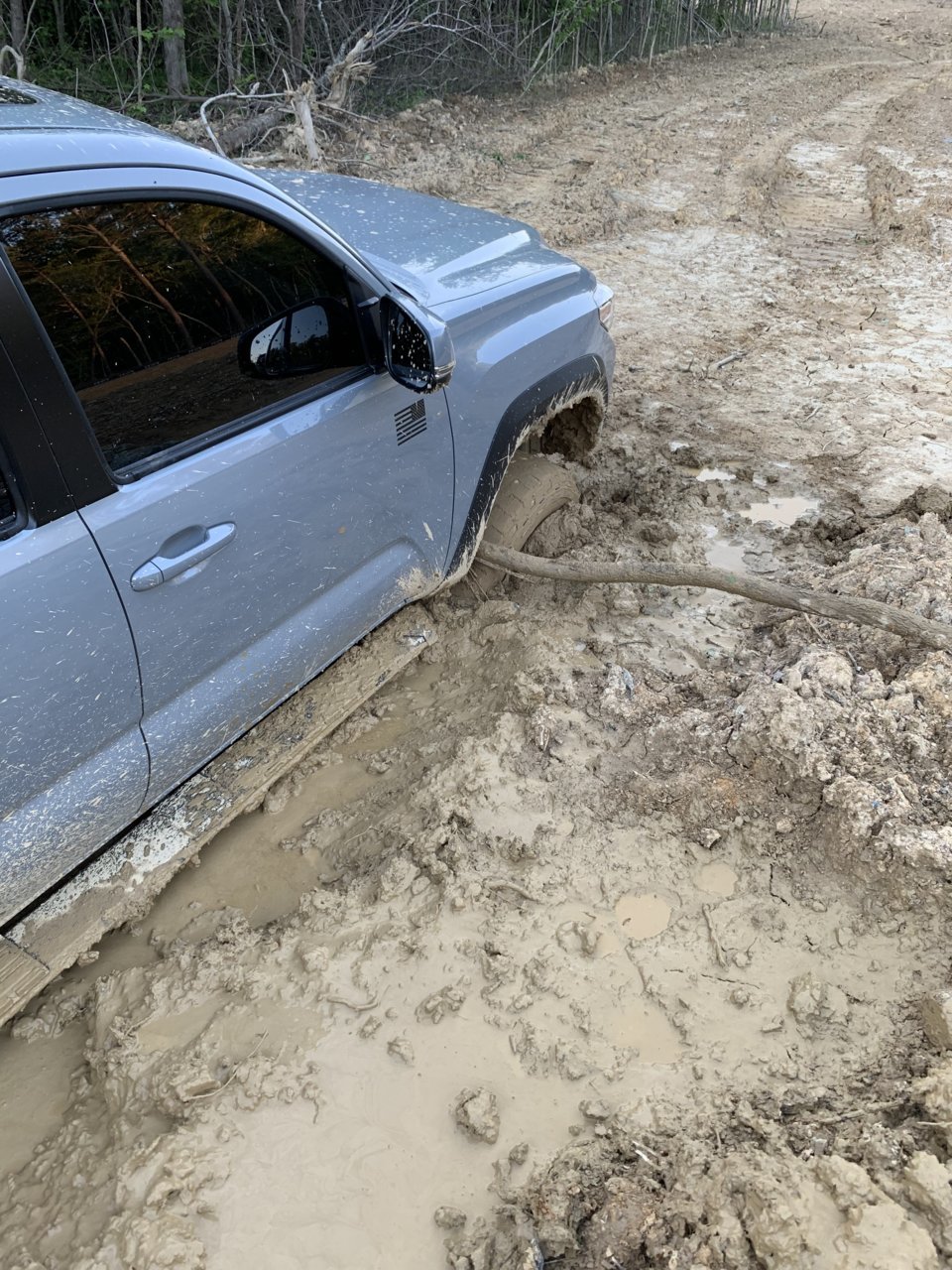

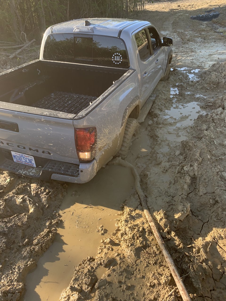

    Pictures are to show how deep it was but if you look the driver side wasn't as deep. so I thought if they all spun together it should have came out?

    Once you're up to your axle and definitely by the time you hit frame, game over. You'll be supporting enough weight that you're not getting enough traction to get out with the mud suck. Only solo chance here is some Maxtrax or other devices to get you enough traction to get moving but in that mess, it will only move you the 42" length of the board before you get stuck again.

    No amount of technology is going to defy physics. As mentioned, if stuck up to frame, you've lost your traction, increased massive amounts of friction, and most likely don't have the tires to paddle that kind of mud.

    Damn... that’s good and stuck! No amount of locking diff and crawl control is going to get you out of that.
    Here’s a good thread to read up on from a old member on TW.
    https://www.tacomaworld.com/threads/recovery-formula.44153/
    If a 20k winch wasn’t budging you and dragging the tow truck I defer to my first statement.

    IN regard to your question, does this generation of Tacoma have a front locker? If not, then I do not think all 4 of your wheels will be turning. With the rear locker, you'll have three turning. I won't address the issues of the mud, tires and winch, but they do call a winch, a fifth wheel. But, one of the postings earlier mentioned that you should know how to use one and the dangers that are inherent with a winch...especially if used improperly!

    It’s possible that wheel had absolutely zero traction so instead of crawl control sending power to that wheel it was applying brake to it so power would transfer to the wheel with more traction.

    Maybe just maybe if you used MTS ( multi terrain select ) . It’s like having front locker . Transfers power to wheel with traction .
