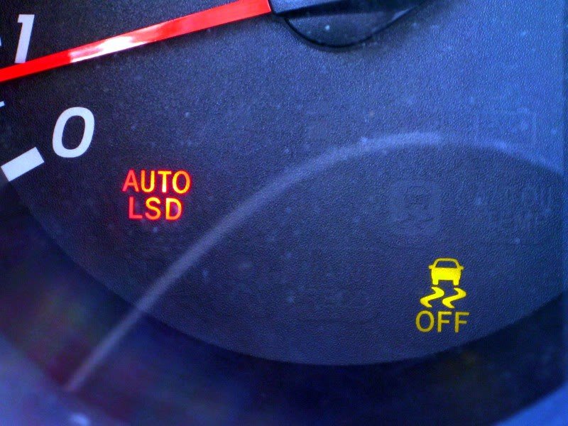

    speedometer .jpgIn the 09+ tacomas when I have the traction control off as shown in the picture does open diff turn into a LSD? I thought it was always LSD all the time my TRD offroad. I ask cause I was going into a steep driveway and got stuck with the snow in the road turning up the driveway then I turned it off and "Auto LSD " came on and I went right up the driveway in 2wd. Do I get better traction when its off? I thought complete opposite...

    David K Well-Known Member
    Jun 27, 2009
    #18969
    10,687
    San Marcos, Alta California
    2010 4WD Off Road DC
    Differential Breather Mod Light Bar: 4 Cree LED lamps Bilstein 5100s Ride Rite Air Bags
    Let me know if anything wasn't crystal clear and I will try and help!
    I said it different ways because we all hear different things and certain words work better than others for some people!
    DAC is like A-TRAC for going down (funny sounds)... Use A-TRAC for crawling up... like 4 wheel lockers.. but different with the same results if you are patient.
    As for the more typical uses of your truck:
    *Normal 2WD is TRAC (light limited slip).
    *Press the button once and turn on AUTO LSD (strong limited slip/ posi-traction) in 2WD.
    *Stop Moving, press and hold in the button for a few seconds to turn OFF traction control and VHS (Stabilty Control) for open diffs.
    * Press button again, or restart truck and your are back at TRAC normal mode.
    In H4:
    TRAC is a strong limited slip naturally (like Auto LSD is in H2), so your only option is to stop and hold the button down for five seconds if you want to wheel without any traction control or stability control.
    (2012 Tacomas might have an extra 4WD TRAC and AUTO LSD choice, instead of them being the same in H4.) We hope to learn the facts from you fellows with your new Off Road Tacos!
    In L4, you got nothing but open differentials at low gear for crawling so one tire in back and one in the front will spin leaving you in the poop or unable to climb that hill.
    The OFF ROAD TRD has TWO systems and a hydraulic brake booster that sets it miles above all other factorty stock vehicles.
    1) A-TRAC turns the truck into a tank on wheels
    2) REAR LOCKING DIFFERENTIAL. For the times you don;t need a computer to power the logical wheel to move the truck, you know that both rear tires spinning together will power you ahead.
    3) BOTH the LOCKER and the A-TRAC can be on together so if your forward progress is halted, then the front tires are under A-TRAC's control below 3 mph! This will pull the front of your beast up and over anything possible... from the factory, stock equipment.

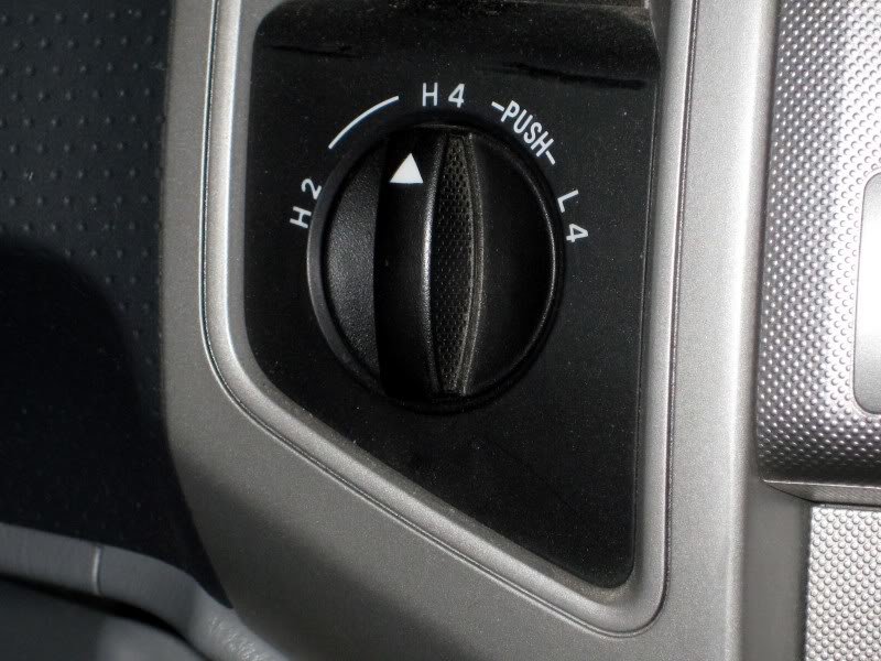

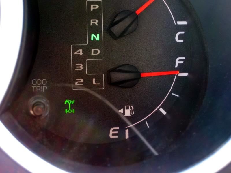

  19. Dec 28, 2012 at 11:52 AM
    #19
    David K
    Jun 27, 2009
    #18969
    10,687
    Yes, thank you!
    1) Turn on the truck... then press the VSC OFF button avatar7907_14_2dbf3432433974eeb60eb958d75d15d11c97c2f3.gif
    You should see these come on:
    Over 30 mph the VSC OFF light will go out.
    Now press the button again to return to 'normal' trac and vsc on modes.
    2) Turn dial to H4... move a bit to see that it engages into 4WD.
    3) Press the VSC OFF button as you did before (don't hold in).
    In the 2009-2011 trucks (and maybe yours?) nothing happens... H4 has TRAC ON normally, but it is the stronger AUTO LSD type of TRAC (no engine regulation). No lights come on in H4 with a quick push of the VSC button.
    IF you get an AUTO LSD light on while you are in 4WD (HIGH), then they indeed added an additional mode... and then note if the VSC OFF light is also on in H4... drive over 30 mph and see if it goes out.
    TRAC without regulation in H4 (or AUTO LSD) is a great enhancement over open differentials (no traction control) when off roading... I could take my 2010 places at full air pressure in the tires that I could not in my 2005, for example... Climbing in high range was nearly as easy as what took low range and locked diff. in my 2005.
    Thank you for your findings!
    FYI... in H2 or H4 if you stop the truck, press and hold down the VSC button for a few seconds, the traction control turns off and VSC is off (unless you drive dangerously and it will come back on). This allows tire spinning... possible getting stuck... but no beep-beep-beep of the VSC warning. When you press the button again, or restart the truck, all functions return to normal.
