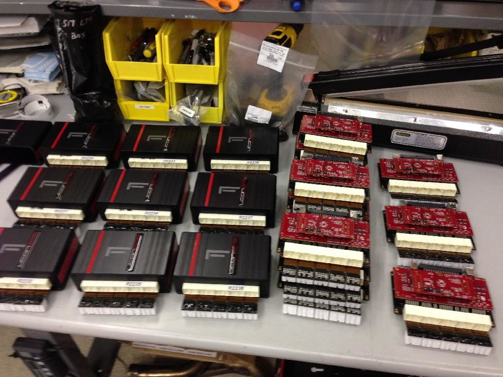

    URD has a supercharger kit for the 4 cylinder to the current model year.
    For the V6 we cover 2005-2008. Toyota is blocking our access to the needed ECU connector to go 2009 and later. We are working very hard to find a work around for this connector issue and we will get it solved. Just do not know when.

    Couldn't a flying lead harness be made for the UCON, to be wired into the factory harness? It wouldn't be as easy an install, but I don't see why that wouldn't work? Use the extension harness for the older Tacoma, out of the UCON, with bare wires at the ends. Ready to be wire in. Basically like how most other standalone EMS' are.
    I think the real reason here, is trying to keep the UCON as dummy proof as possible. Lol.
    BTW, OP, '09 + have been running on various aftermarket EMS'. They just have to be wired into. Just don't get the UniChip, unless to purchase the harness.

    With the current version of the UCON we are just grabbing and controlling way to many signals to do a customer wiring job. The current tech support load on just wiring the MAF Cal proves that it is just not a doable alternative.
    Trust me, there are way more connections than your stand alone system.
    We will get this solved, one way or the other.
