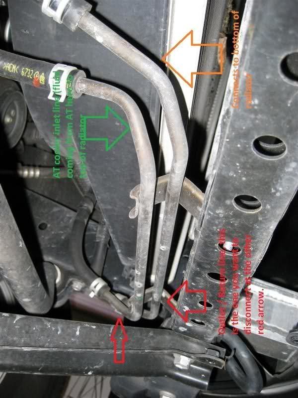

    Took my radiator out of my ‘07 tacoma trd to have better access to the harmonic balancer to replace the seal. Started my truck briefly to make sure that’s where the leak was from and oil came out of a hose. It’s about a 1/2” hose that connects to metal piping. Is this normal? Also fairly certain it was connected to part of the radiator

    Tranny fluid, maybe

    yeah guess would be the transmission cooler you disconnected from the radiator like @Steves104x4 said

    Tranny cooler is my guess as well. Do you have the Tow Package?

    Maybe these are the lines you are referring to?

    Yes!
