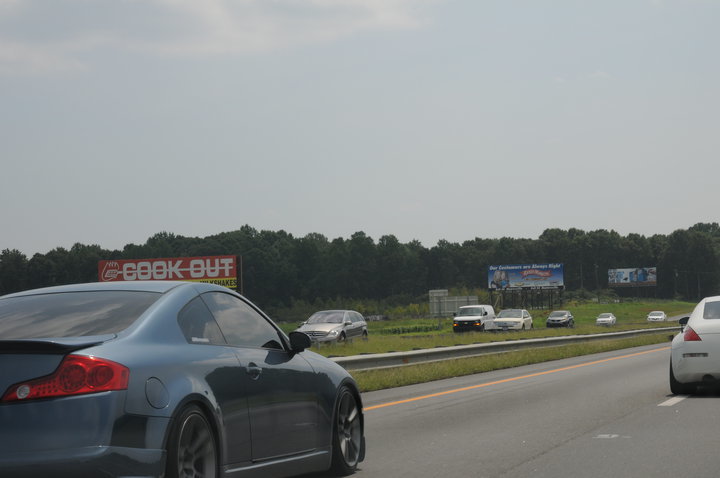

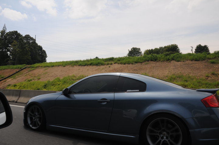

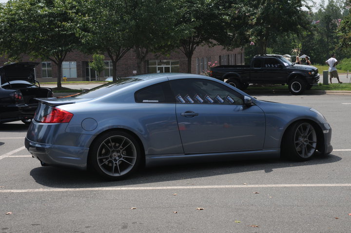

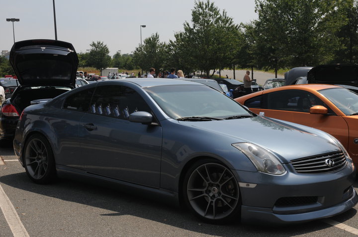

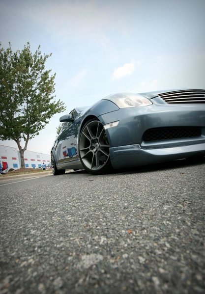

    Here's some shots of my old girl. Lot's of time, effort, blood, sweat and tears went into her. I did all work and mods myself, and she was a clean car. After the lip kit it was just too low to daily drive. I miss her at times, but every time I have to pull over a steep curb or speed bump, I get a sense of joy in my truck that nothing can stop me!

    thats a good lookin car, i like the black tacoma in the background of the first pic too ha ha

    That truck is nasty. He's one of the guys with sohomotorsports. It's turbo'd. They had the dyno sheet on the truck, I can't remember what the numbers were, but it was over 300.
