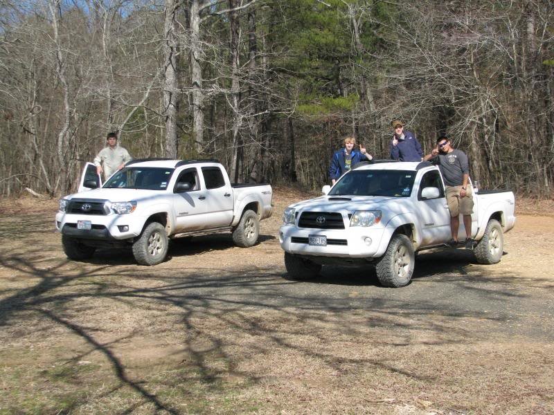

    If you are thinking of going 1.75" w/ Bilsteins' in the front, do yourself a favor: Save a little more and get the Eibach coils and set the Bilsteins on zero. You will have the same lift, but the truck w/ Eibach coils rides much better offroad (big hits/bumps). I've got two trucks, done it both ways, wheeled them both off road side by side in the same conditions - Eibachs are money well spent...
    My son and his friends on a recent trip to Arkansas with our two trucks. Both have air bags in the rear instead of add a leaf. The off road has 265/75 R16 Mickey Thompson ATZ's, the Sport has 265/70R17 MT ATZ's.
