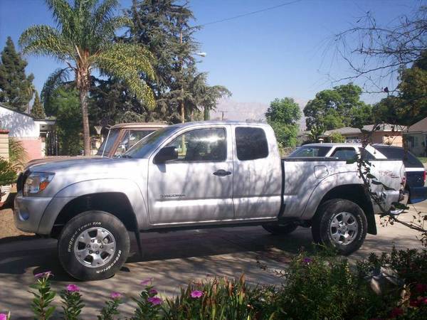

    here is pic of toytec notice how its nose high i forget what height they were set at prolly at around 2 but the toytec "coilover" lifts a lil more compared to a 5100 and stockspring due to the small top plate spacer on the toytecs
    here is pic of tsb+toytec in drive way amost level
