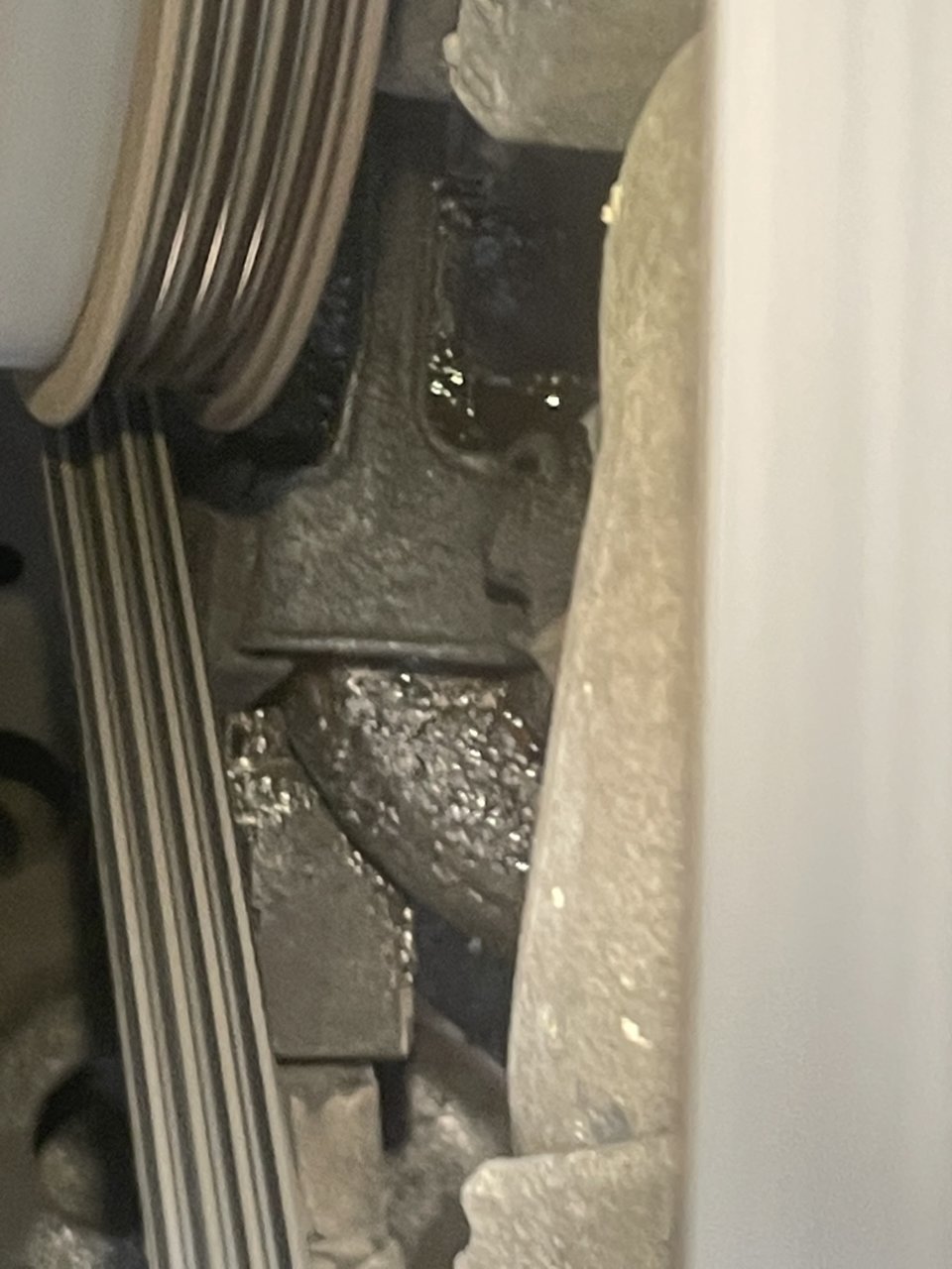

  14. Dec 28, 2021 at 10:19 AM
    blackpiglit
    blackpiglit [OP] Well-Known Member
    May 4, 2019
    #292218
    142
    I was starting to hope it really was just splashed coolant working its way down the engine but the leak started again today.
    It's def not coming from any radiator hoses etc but it's really hard to tell exactly where the origin is.
    Doesn't help that my front main is leaking oil so it's a bit of a mess. At some point I need to do the timing belt/ WP/ seals but it's not good timing for me so I'd love to put it off a little longer if I can trace the leak to something else.
    The bypass tube that's famous for leaks is the rubber hose coming off the driver's side of the thermostat, right? It's not coming from there. But it also doesn't really seem to be coming from the water pump? At least it's not getting on the pulley or spraying around the bay at all it's just dripping straight down the face of the engine.
    Can someone tell me where the weep hole is on the water pump housing?
    It's possible that it's coming out of either the WP gasket or maybe the bottom of the thermostat housing gasket.
    Def not coming from the rad hose.
    Are there any other possible sources of a leak in the area of the water pump / thermostat housing?
    Like I said it was dry as a bone while driving at temp on the highway for a while and then just started again this morning after going like 3 miles, no highway. So it's weirdly intermittent, only happens when at temp/pressure but not all the time.
    Is there any point in a pressure test if it's on the engine side of the system? I did replace the rad cap because why not but I'm 100% sure it's not coming from the radiator or any of the hoses.

  16. Dec 28, 2021 at 7:29 PM
    #16
    CodeSeven
    CodeSeven LOC: 33.781461, -115.867251
    Aug 20, 2014
    #136597
    2,186
    Serge.
    Coachella Valley
    '00 Taco 3.4 4x4 TRD ( <3), '06 Taco Prerunner 4.0 (totaled)
    3 inch lift. bluetooth stereo. blue transparent skulls shift knobs
    the upper hose is connected to a water outlet thats bolted on the intake.
    the intake gasket handles coolant at the upper hose.
    these you can check by simply looking down in from the top of the engine behind that timing belt cover.
    the water pump is right there.
    yes the thermostat gasket on the water pump.
    yes the extra hose but i think that's just for automatics. you got one?
    these you have to take off the front covers to figure it all out.
