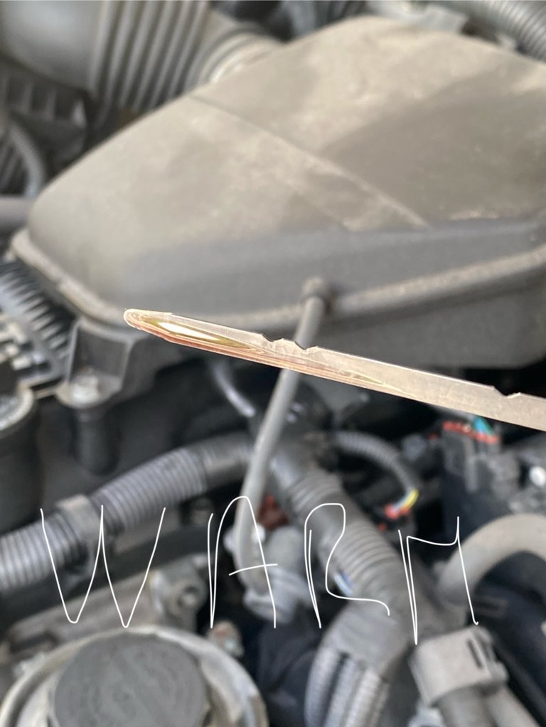

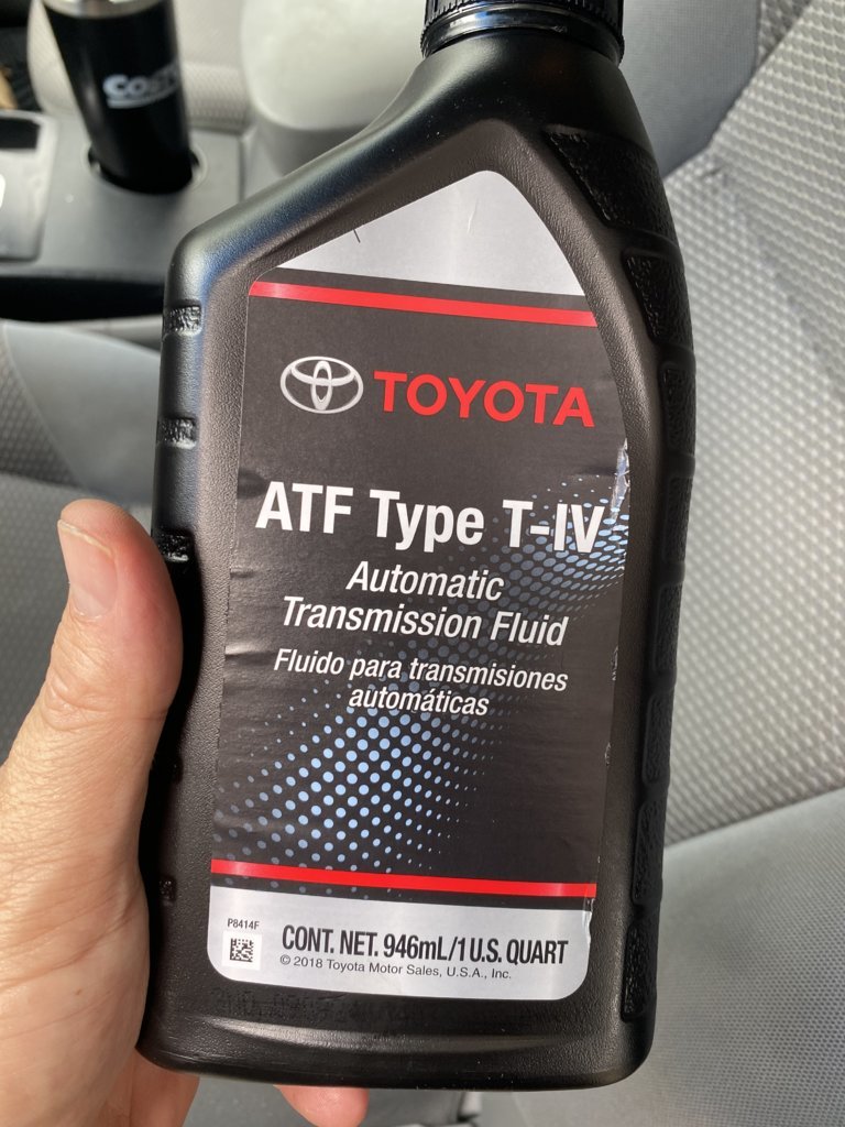

  9. Oct 13, 2024 at 6:45 AM
    Turqui
    Turqui [OP] Well-Known Member
    Jul 10, 2022
    #401099
    81
    2006 toyota tacoma

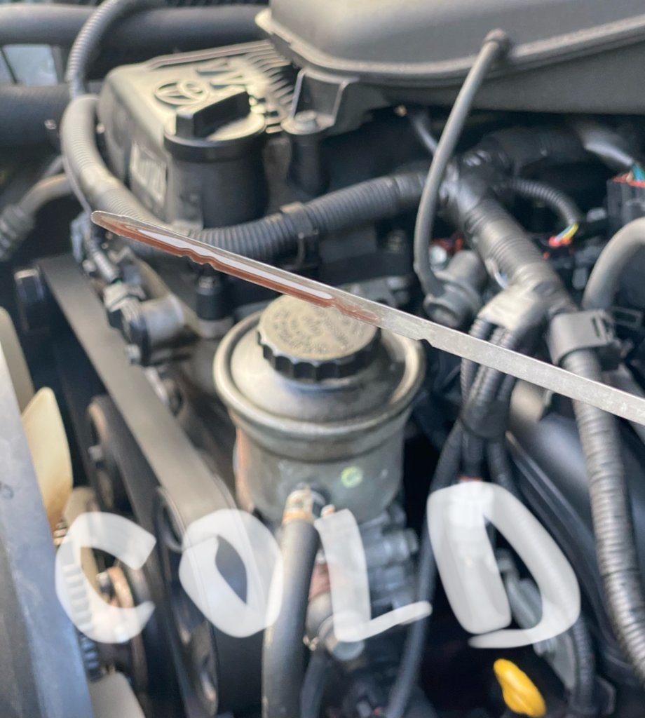

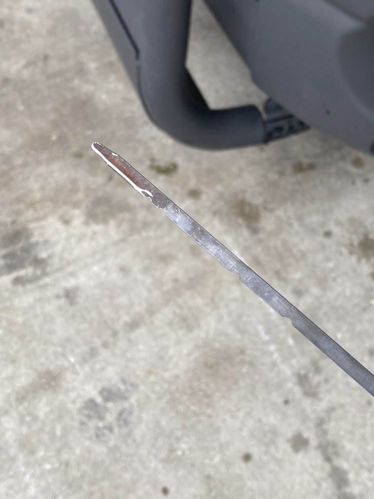

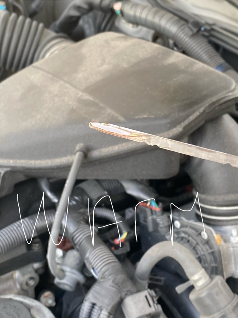

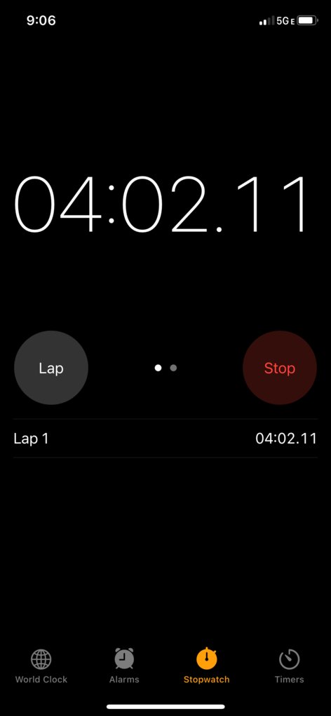

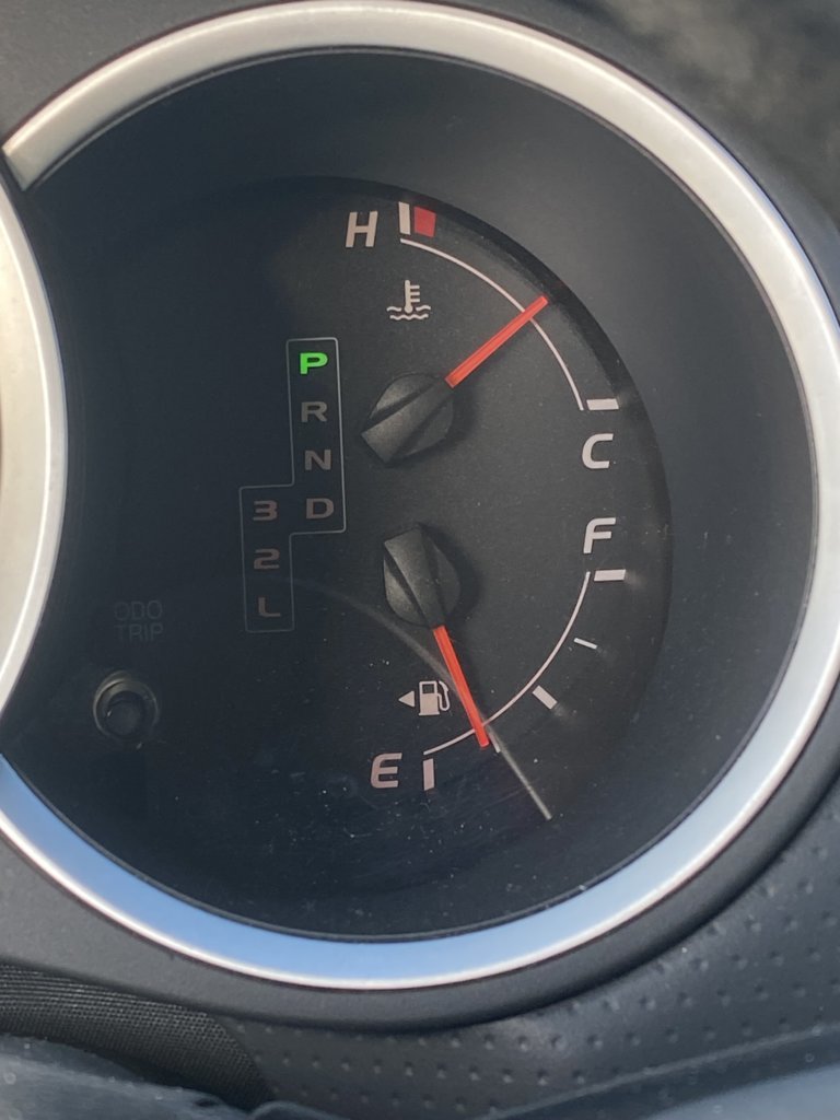

    Hello there, this is getting more confusing.
    I posted a few pictures of the steps.
    Checked the transmission oil this morning without starting the car, cold check, the level was on the Hot area in the dipstick.
    Then turned the car for a few minutes, drove it around until temperature reached normal center. Parked the car, put it in P(park), let it sit for 4 min, started checking the transmission oil again and now is in the cold mark.
    Any ifeas? Its not supposed to be the opposite? Sorry my ignorance, that is the reason i ask for your knowledge.
    Car got 5 quarts poured after drain and fill, but it didn’t feel it drained so much. Otherwise i have to note the car drives great. any ideas?
  10. Oct 13, 2024 at 6:55 AM
    Knudsen
    Knudsen Well-Known Member
    Aug 8, 2024
    #454753
    404
    Jon
    2008 Access Door TuRD
    To bet installed: bling grill, headlights, fog lights.
    I’d guess there was some air that worked its way out.
    Did you check the fluid before servicing it? If so, was it pink? Brown and stinky is bad.
    Others here are schmardter than me. Listen to them.
    Drives good probably means is good.
    Turqui[OP] likes this.

  15. Oct 13, 2024 at 7:20 AM
    Tacoma Mike
    Aug 6, 2011
    #61230
    31,475
    Southern Maine
    Converter drain down.
    Normal.
  16. Oct 13, 2024 at 7:41 AM
    #16
    Dm93
    Dm93 Test Don't Guess
    Mar 3, 2015
    #150066
    13,639
    Texas
    2014 DC OR 6spd 4x4
    Predator tube steps, Ranch Hand grill guard, Magnaflow CatBack exhaust, Toyota tool box & bed mat, 2LO Module by @Up2NoGood, Rearview Compass/Temp Mirror, Tune by @JustDSM.
    Dont turn it off to check the transmission, always check an automatic transmission with the engine running in park unless service info or the dipstick says otherwise.
