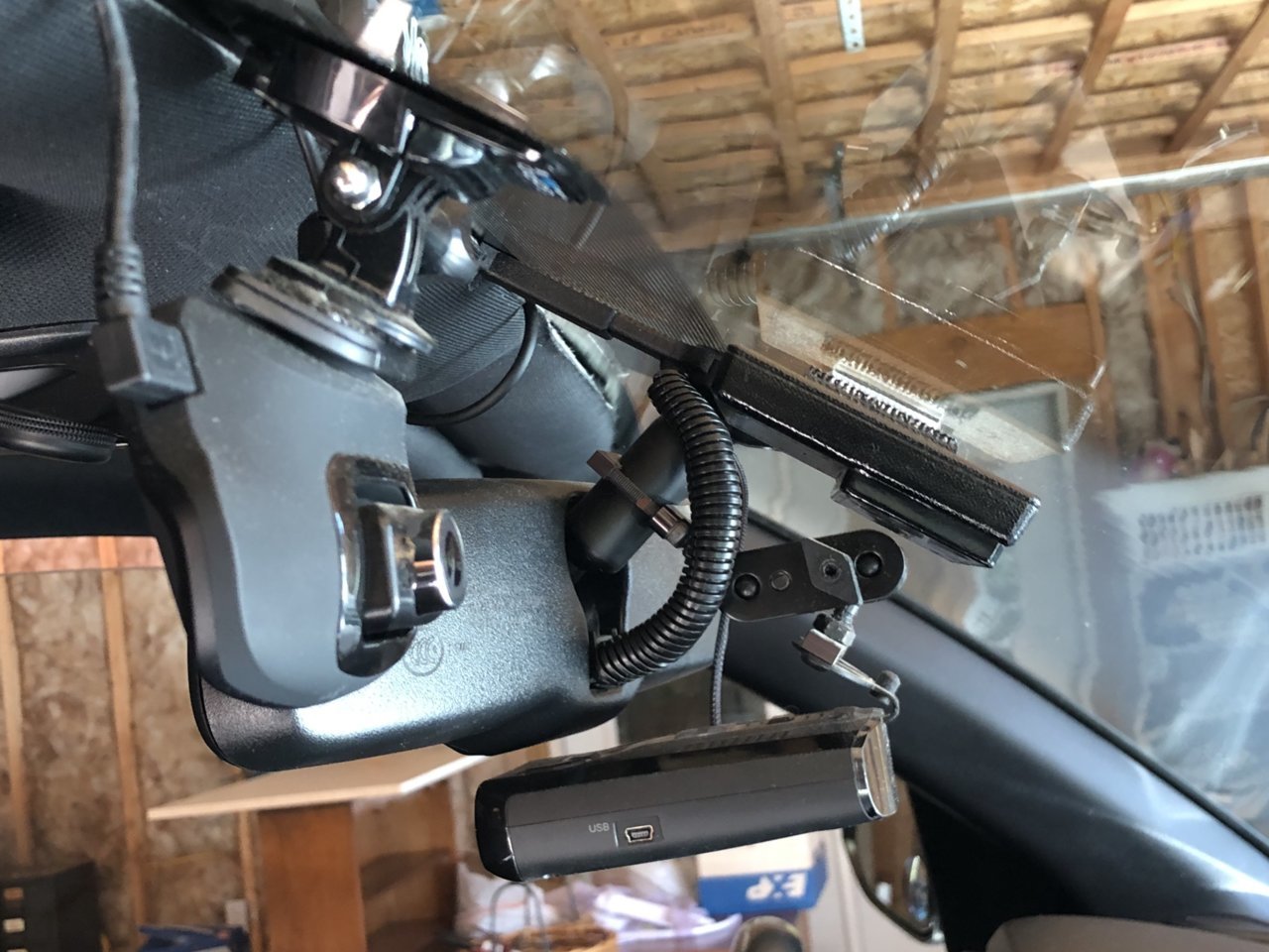

    I ran mine behind the roof liner, down the windshield side of the apiller to avoid the airbag and to the console power port with a plug in. Took 5 minutes to hide the wires.
    Look in my build thread electronics section after my ham radio write up.

    42863E73-0991-4136-9152-D61845B56A68.jpg 3BC4CEB6-ACD9-41D5-BA86-65FA88BD5FED.jpg

    You running your ham radio, dashcam, and radar all off the power from the mirror? Would think that would draw too much power.
    Did you use the dongle from earlier in this thread?

    Correct. Only the 2amp radar is off the mirror.
    The dashcam is powered from the acc port in my console.
    The ham is installed on a branch circuit purpose built in the whiskey compartment behind the rear driver’s side seat. I have an auxiliary battery and charger hooked up there as well so I can by on air, but not on battery. Decent write ups of all three in my build threads.
