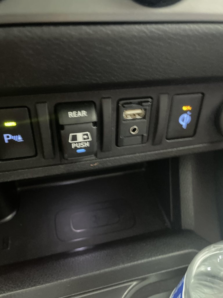

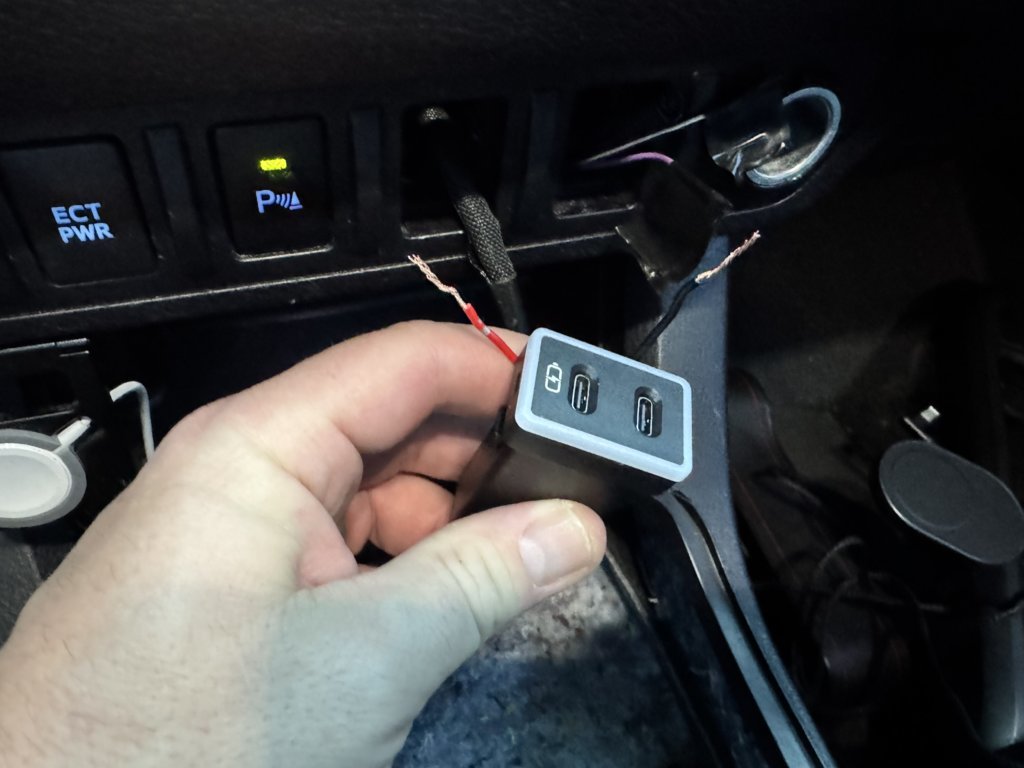

    I’m trying to replace my stock USB switch (it stopped working) with a USB-C switch and can’t get any power. Now granted I’m NOT an electrician at all but any help would be greatly appreciated!!!

    I believe it is. Once I plug my phone in,it gives me an option in my audio settings to select USB. I have no clue on how to wire it into my truck.

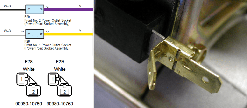

    If you still want to use the replacement, tap the wires from the "cigarette" lighter port.
    stealthmode, auskip07, RDT415 and 2 others like this.

    AutoZone usually has those piggyback connectors.

    Tape or heat shrink the exposed metal on the piggyback connector.:bananadead:

    Just the factory one that’s underneath the climate controls. It has an auxiliary input with it.
