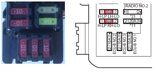

    Add-a-fuse to a relay to activate at same time with low beam.
