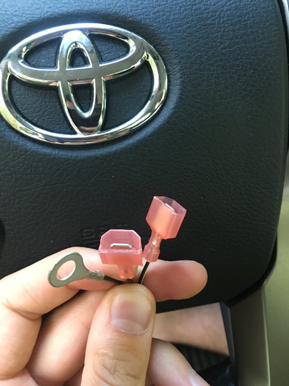

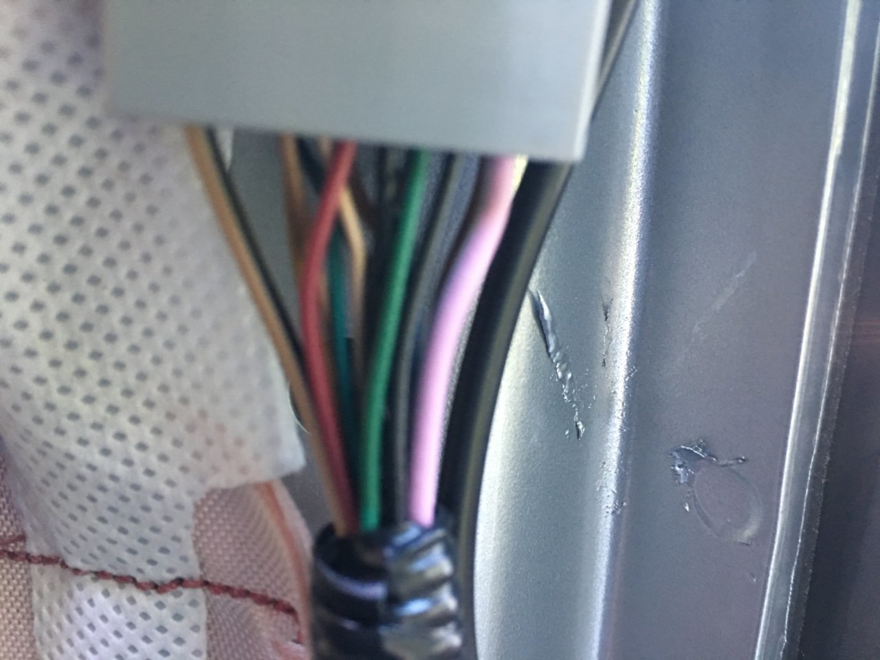

    073DEE13-61B5-47D4-B5CD-B7A95C8FC18A.jpg I’m installing a power mirror in place of my non-power “plain” rearview mirror and need to wire it to the 25 pin connector in the A-Pillar. How do I do so? This is what I’m working with:
  2. Aug 10, 2019 at 2:22 PM
    11,748
    I.D. the 3 wires (I see a ground) and we may assist with the Tacoma Connector. (IN1)

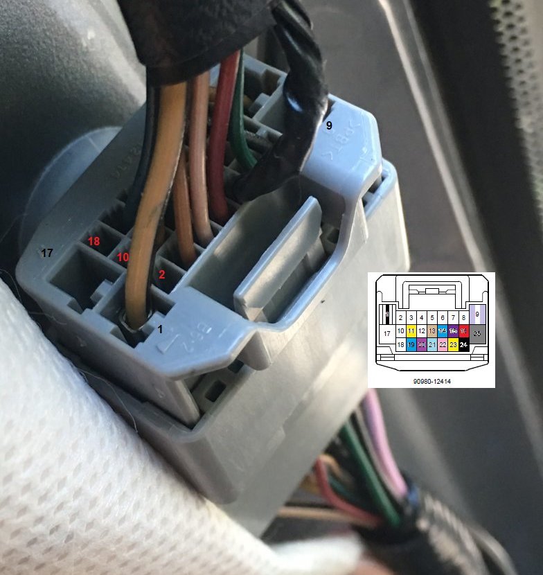

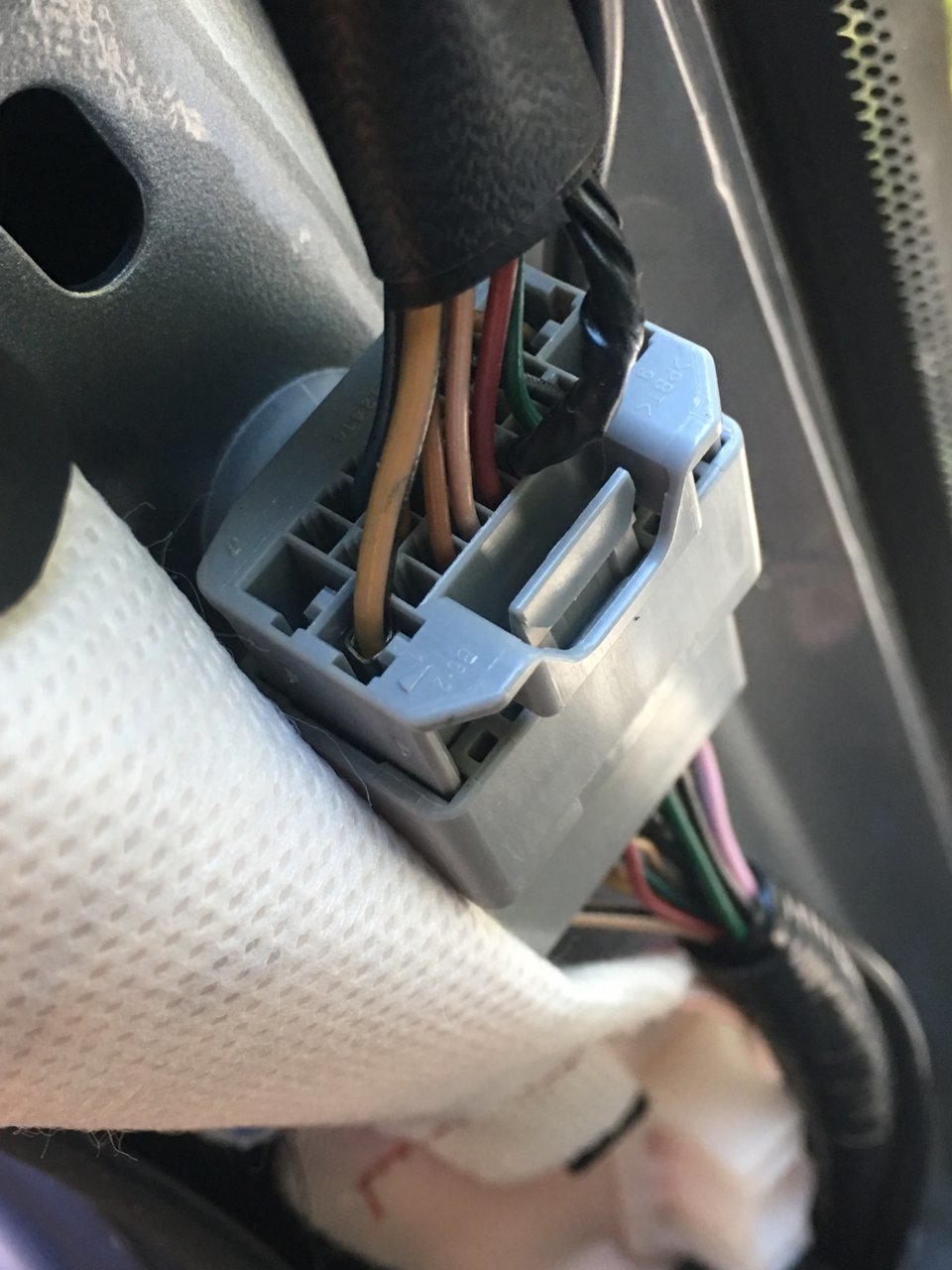

    I’m sorry but I’m not able to pull off connector to get picture of underside (it seems pretty attached to A-Pillar) if I unclip wires will it set off airbags or anything? Here’s a picture that may or may not help, thanks for your help

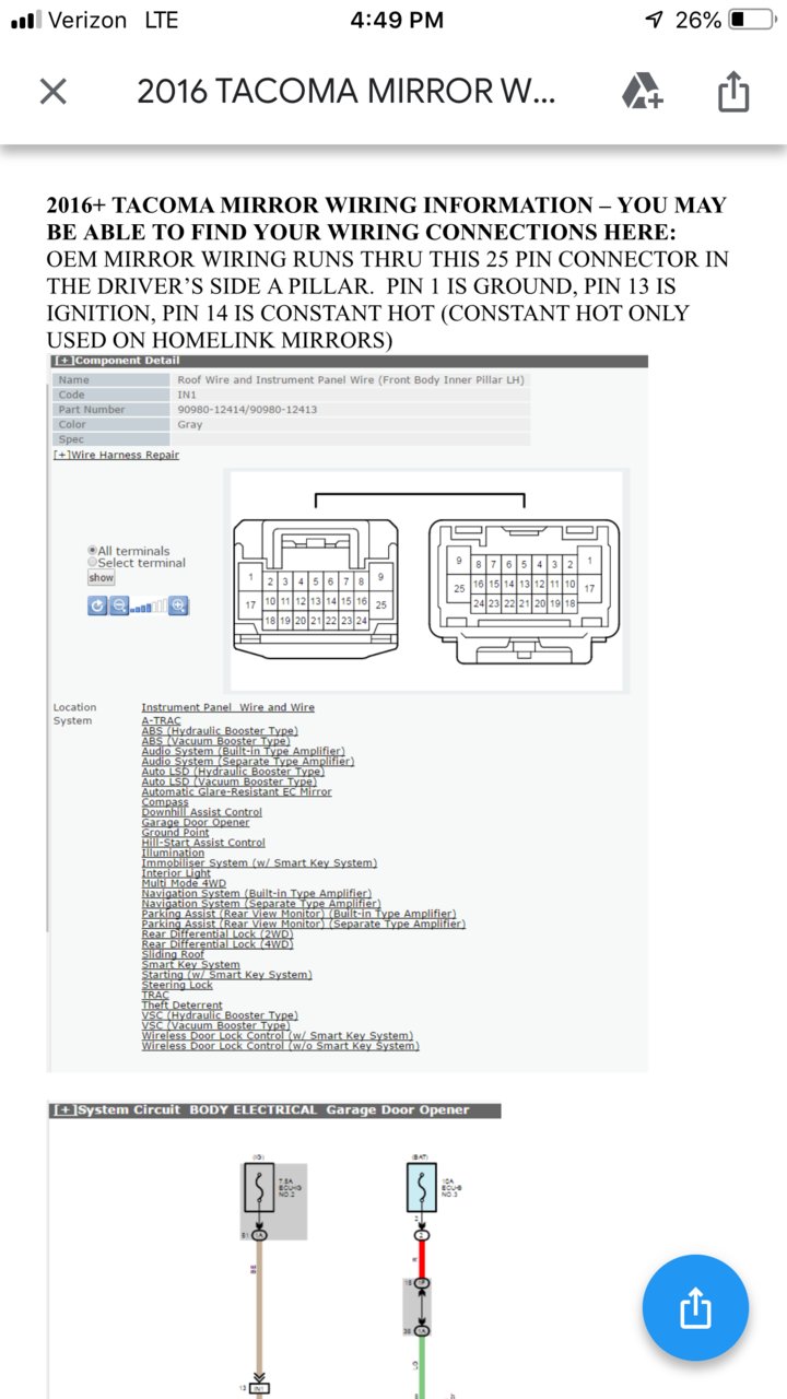

    I have this information but I’m just not sure how to actually connect wires with provided wire harness... do I cut off all connectors at ends of wires and slide in the ends of wires into corresponding slots mentioned into 25 pin connector? Thanks!!

    Yes those be the ones I mentioned #13 (IGN) & #14(BAT):
  7. Aug 10, 2019 at 4:36 PM
    11,748
    Look from underneath, middle row...I can't see if the topside connector has them.
  8. Aug 10, 2019 at 4:39 PM
    11,748
    You might even have this connector taped up in the overhead.
