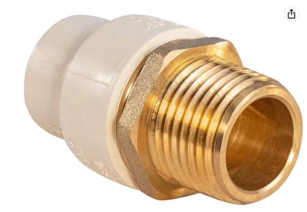

    I'm installing a brass backflow preventer, a ball shutoff valve and a brass spigot in a pvc sprinkler system and when I looked at recommendations for joining pvc to metal, there are many, many opinions. Consistently, there was "do not use Teflon tape on pvc, it will break it".
    One option is a PVC/Brass union, which I do like, but they are $12 each. That's a lot of cheddar when I add it up.
