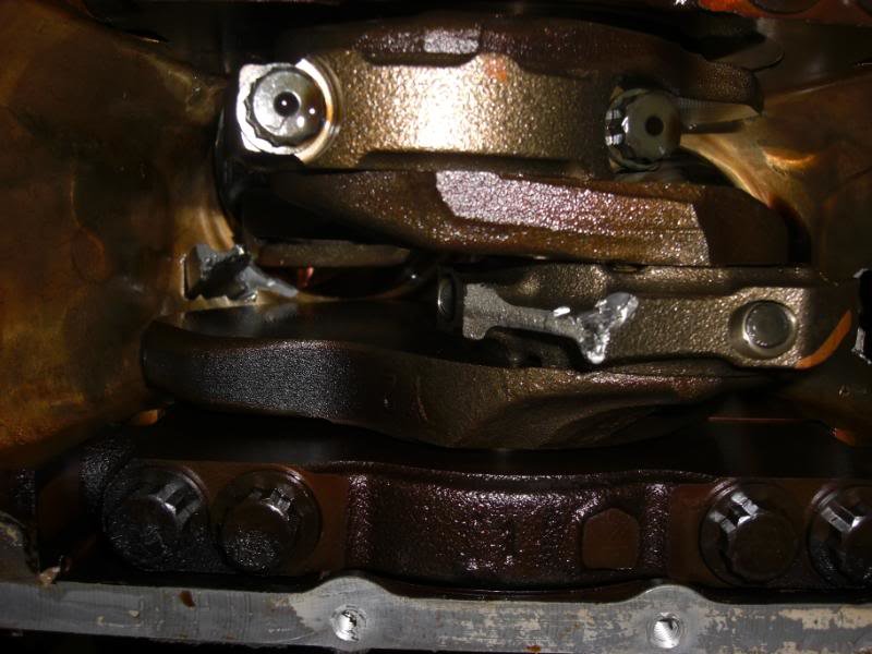

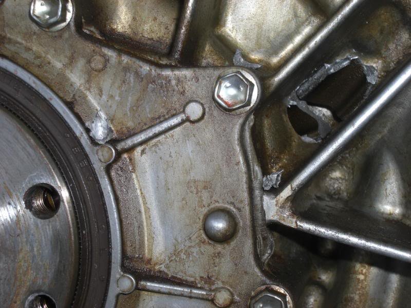

  15. Oct 1, 2015 at 8:54 AM
    Torspd
    Torspd Tor-nication
    Sep 18, 2009
    #22958
    26,313
    Tor
    The Great America!
    MMVI 4.4L 4x4 Access Cab
    Torspd Custom Turbo kit [] Borg Warner 9180EFR Turbo [] Haltech Elite 2500 [] TiAL Q BOV [] TiAL V44 Wastegate @ 15psi [] CP Pistons [] CP Carrillo Rods [] ARP Head studs [] ARP Main Studs [] ARP Header - Head Studs [] Ported Heads w/ 1mm oversized valves intake/exhaust [] Brian Crower Forged Stroker Crank [] Darton M.I.D. Sleeved Block [] Kelford Camshafts [] Torspd 160* T-stat mod [] APR Large Fuel Rail [] Walbro 460 LPH E85 Fuel Pump [] FueLab FPR [] APR T56 Conversion Kit [] KP RACING Built T56 [] McLeod Racing Custom Twin Disk Clutch [] One Piece Aluminum Driveshaft [] MGW Shifter [] Custom lowering kit [] Ohlins Front Coilovers [] QA1rear shocks [] Custom Ron Davis Radiator [] Dual SPAL Electric Fans []
    My failed rod.

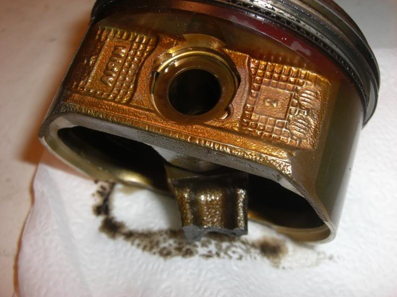

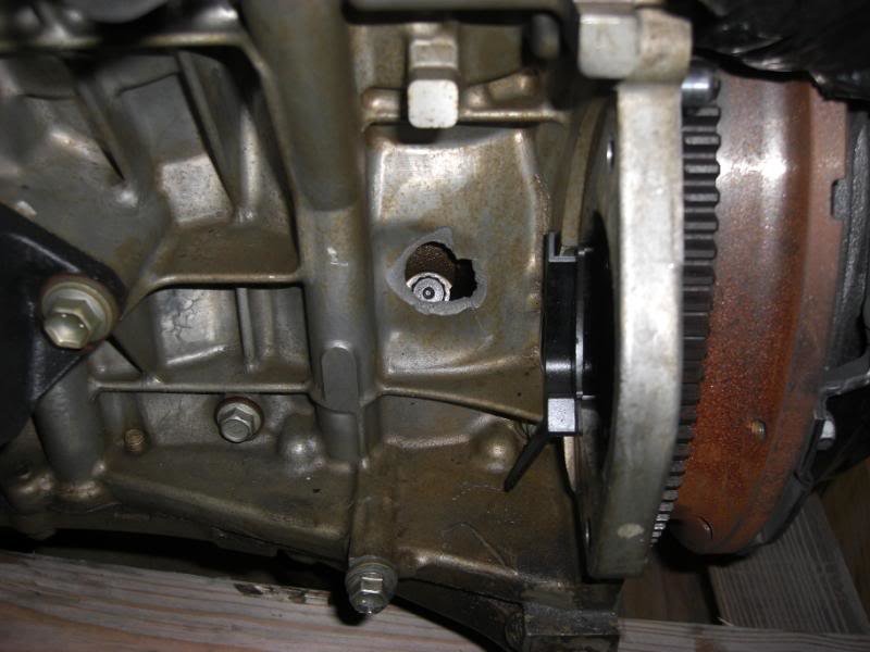

  17. Oct 1, 2015 at 10:22 AM
    #17
    Torspd
    Torspd Tor-nication
    Sep 18, 2009
    #22958
    26,313
    Tor
    The Great America!
    Only the deck. ;)
  18. Oct 1, 2015 at 10:35 AM
    #18
    Poofyfoot
    Poofyfoot Well-Known Member
    Oct 23, 2013
    #115097
    94
    Jordan
    Logan, Ohio
    89' Pickup and 2013 AC Sport
    This happened with my 22re once... Here are the results. This was a brand new engine (<3000 mi) that had a bolt back out, the connecting rod was all mangled up... I'll have to find a pic of it too. Warranty covered the replacement.

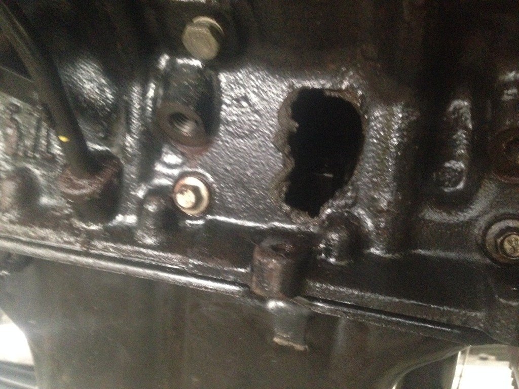

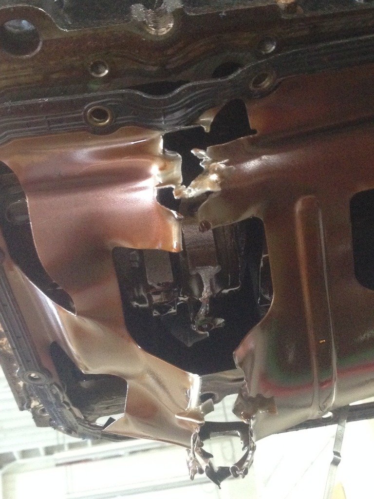

  19. Oct 1, 2015 at 5:31 PM
    #19
    yesmar
    yesmar Well-Known Member
    May 1, 2013
    #103280
    681
    Ramsey
    Harrisburg, PA
    A couple cars
    Pulled this out of a hemi in a Durango at work. Pretty epic the rod broke twice, hole in both sides of the block. Someone must have let her run a bit lol
    B4670CA2-22AE-4277-980E-F6DE04C1EC99_zps_2728b1cdcd2565f9addfe807ca9bce1823c04526.jpg
    1ED831E6-9196-4C3D-B39F-A62AD8019994_zps_ed2d9075c298e20207ca062a20c254b66dc530af.jpg
    12TRDTacoma likes this.
