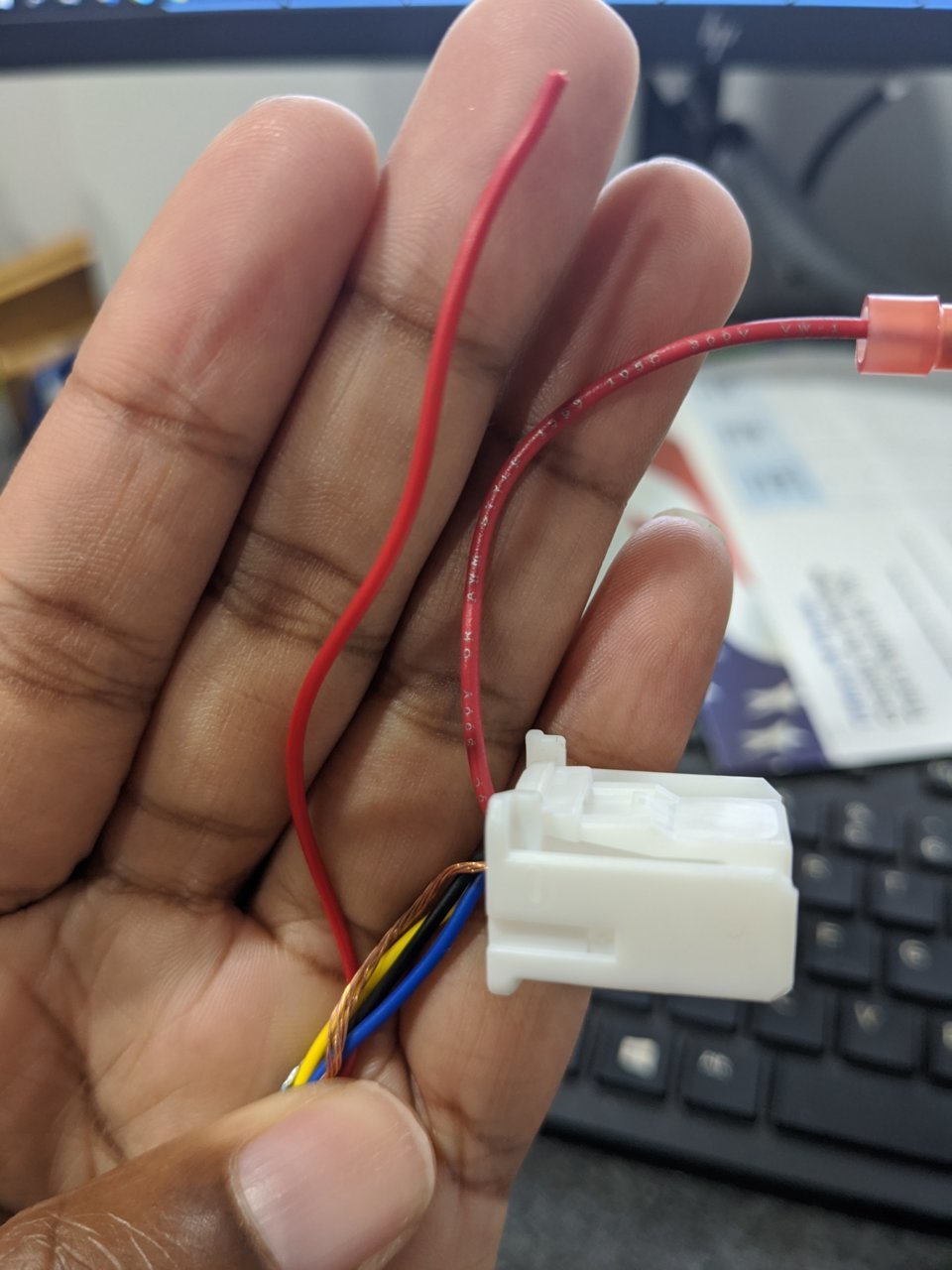

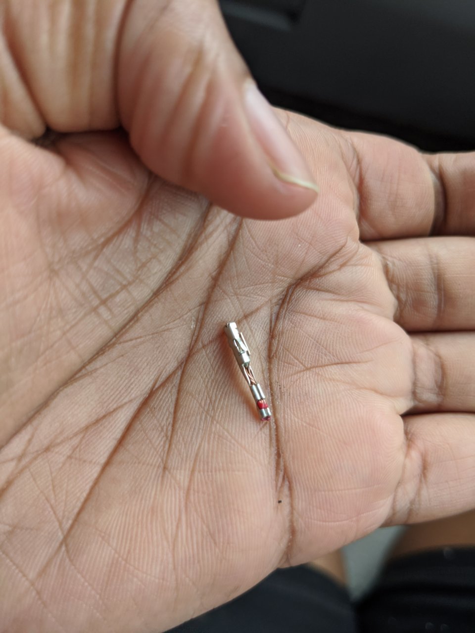

    Hello,
    First post. Just bought a 2013 Toyota Tacoma. The backup camera was in the mirror so I bought the conversion kit from Camera Source to move it to the radio. Well in trying to put one of the wires in the harness it snapped off. There is still enough wire to crimp but not sure how to crimp and what is needed. Any assistance would be great. Thanks

    This is the info and all the pieces that came with it. So it's the red wire that was broke off as you can see in the picture that needed to go into the back of the 28 pin harness. It is what is the reverse wire that I would tap in to.

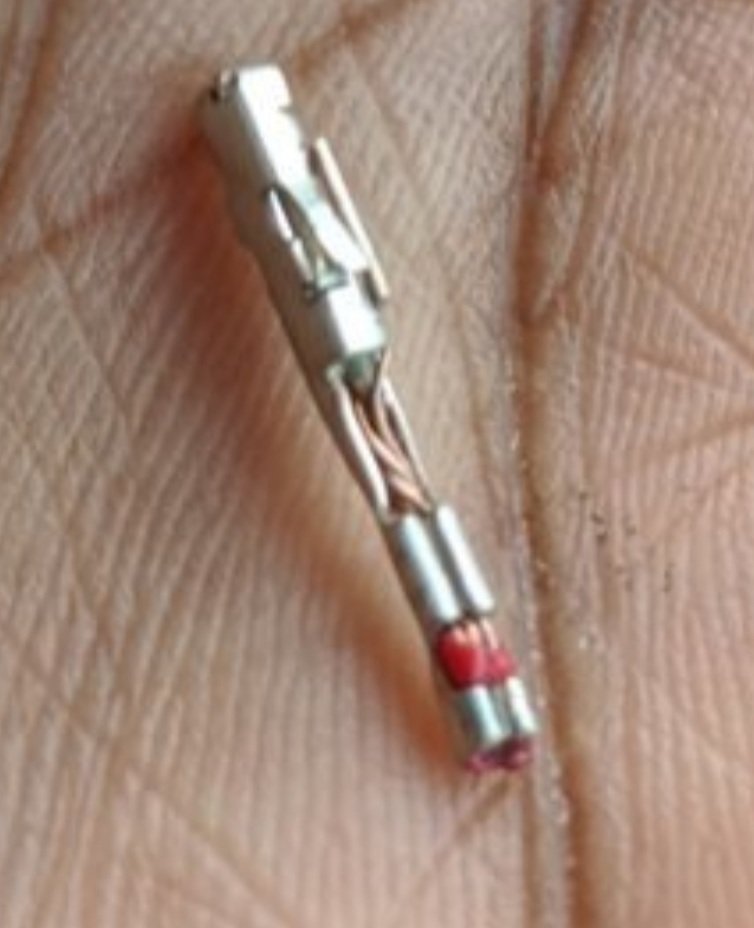

    You can either solder it right on top of the portion where the red insulation is or you can spread apart the crimp in the same spot, remove the insulation, insert the new wire, recrimp, and then solder it. Either way it'll work forever.

    :oldglory:soldering where the red insulation is, is easier
