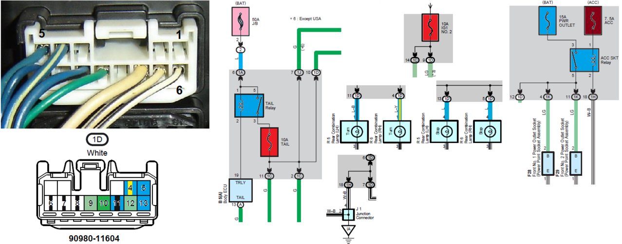

    Doing some research I found that connector 1D has an empty slot as part of the Power Outlet circuit. Also, since I have an Access cab and not 4WD, there's also a 10A IG1 No.2 slot available.
    Might help others to add an almost OEM circuit.
    They use 090/2.3II female terminals.
    https://www.corsa-technic.com/item.php?item_id=809
