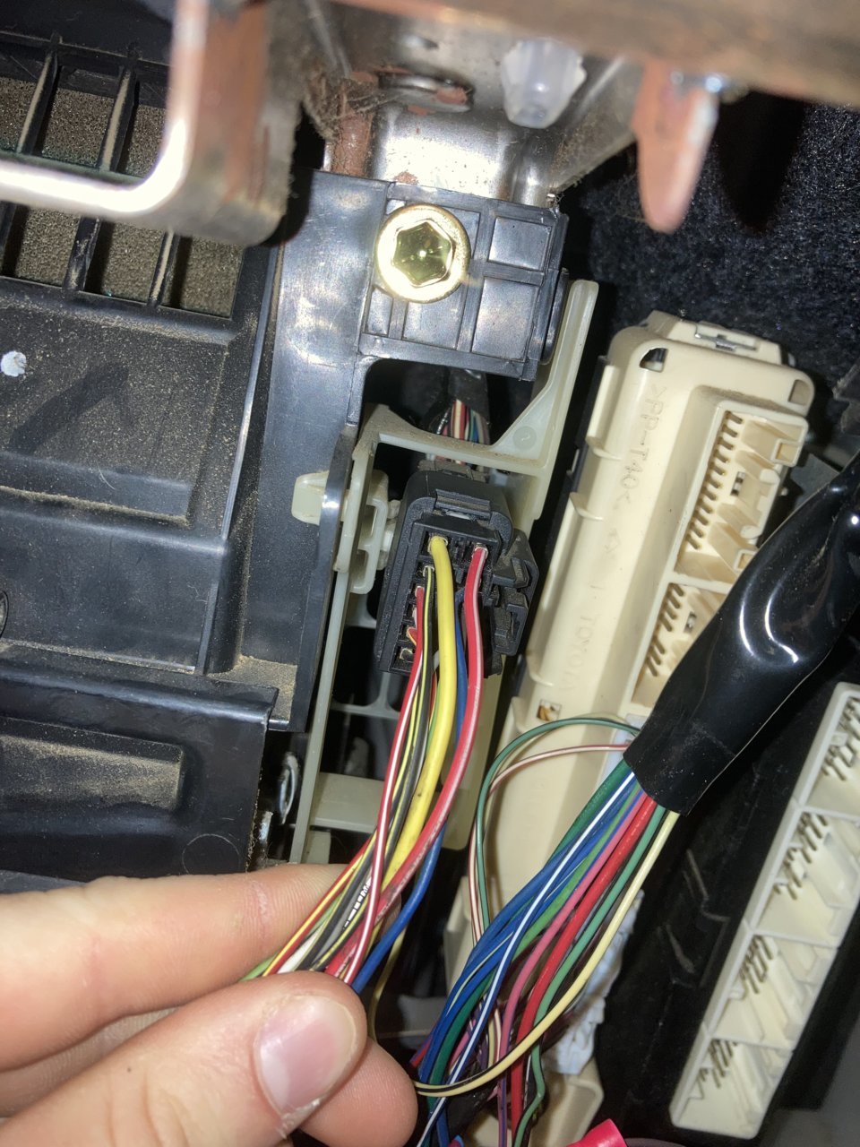

    Hey guys,
    wondering if anyone could help me identify a connector. It’s a 12 pin connector behind the glovebox right next to the ecu.
    Any info at all is helpful. On the off chance that someone has a diagram or pin out of the connector that would be awesome! Thanks!

    Looks like the IH1 connector
    It goes to numerous different things.
    If you can tell us what it is you are doing, we can help more.

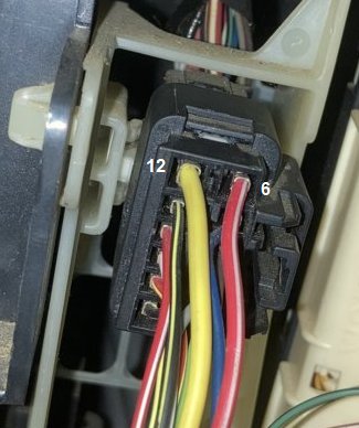

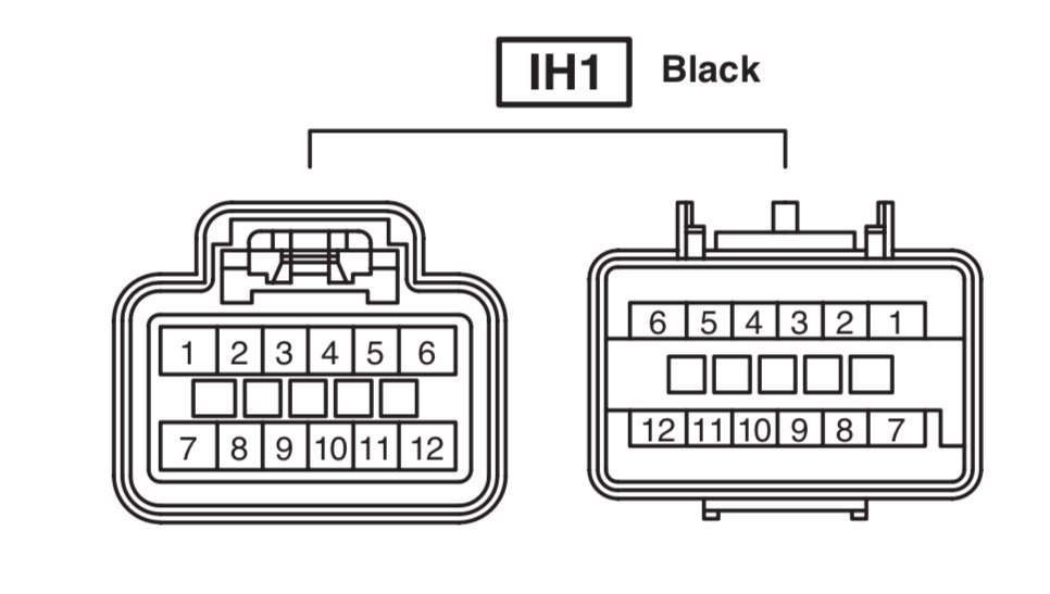

    I'm working on connector pinouts but I haven't finished it yet.
    Here's what I have on IH1

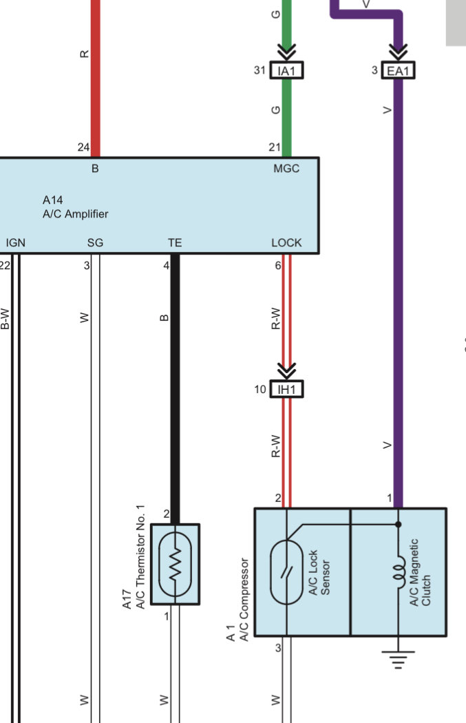

    IH1 #10 to AC Amplifier
    Dm93 likes this.

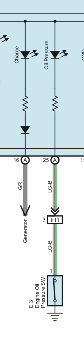

    IH1 #3 to Oil Pressure sensor
    Dm93 likes this.
