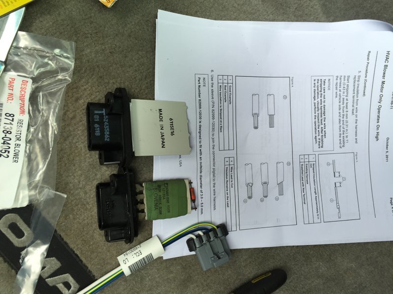

    I got at my local dealer. $64 for both female plug pigtail and new make side with resistor. Appears the updated the resistor. Old one on the right with new one the left. image.jpg image.jpg

    yep i replaced that resistor and the actual connector that plugs into the blower motor and eventually the blower motor itself. After replacing it ALL lol it worked.
