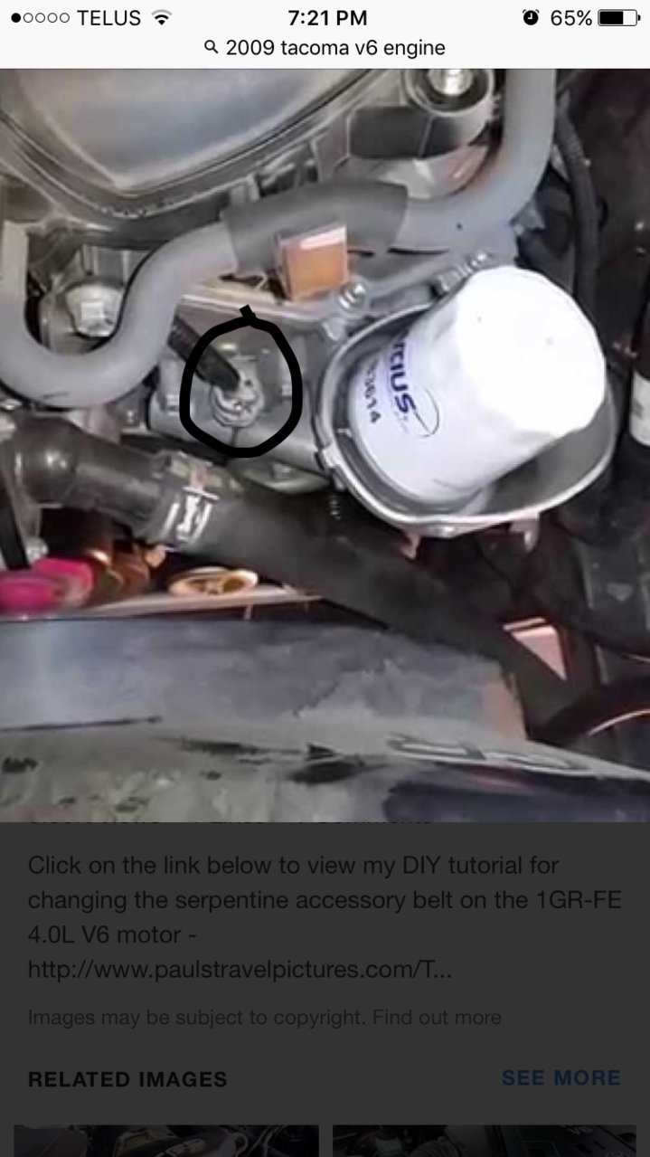

    Hi guys .new to the forum .just bought a Tacoma .
    Few thing about the truck .its an 09 v6 4x4 reg cab 225000 Kilometers.
    The other day I noticed a connector was disconnected right on the body around the oil filter .any idea what's it is for and possibly why it was disconnected .

    It an electrical connector .the wire was disconnected from the connector .i reconnected it and nothing changed .just wondering what it does .im familiar with the drain spot .

    Not around the truck ATM but I found this pic online of the connector I'm talkin about !IMG_3901.PNG.jpg

    Oil pressure sender, if its unplugged you should have a check engine light.

    I've had the truck for 3months and haven't had a check engine light .plugged in back in and still no check engine light

    Does check engine light come on when you turn the key before starting it? If not, your light could be burned out or removed by previous owner.
    I'd get a code scanner and see if anything is amiss.
