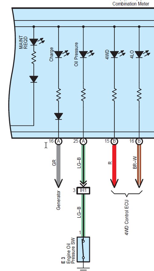

    The oil pressure switch is a normally closed switch one end is connected to ground and the other lead comes from the Combination meter. When the engine is running and Oil Pressure is proper the switch opens.
    With the engine off the switch should read a short between the terminals of the switch. With the engine running the switch should read open between the terminals on the switch.
    That is why it doesn't light up when it is disconnected. If you short the two wires in the plug the Oil LED will light. Your system seems to be operating normally.
    The only thing that the switch does is illuminate the little oil can LED in the dash. It doesn't go anywhere else.
    12 VDC to Combination Meter to Oil LED to Pressure Switch to Ground.

    when Turning the key to on the oil light comes on with sensor connected but does not come on with sensor disconnected .but also no oil light when truck is running with sensor disconnected .did Toyota design this sensor like this ?that with it disconnected the driver wouldn't know they had an oil pressure issue

    With the engine NOT Running the switch is closed to ground completing the current path to light up the Oil Can LED in the dash.
    With the engine Running the oil pressure opens the switch disconnecting the ground and the current path for the Oil Can LED in the dash is open and the LED is Off.
    Knowing this much about the circuit it is obvious that with the connector disconnected the circuit is open and there is no current path to ground and the LED cannot light.
    And you are also correct that if the connector is disconnected and the oil pressure is lost you will not know until it is too late and the engine is damaged.
    Easy solution is that you check when you start the engine that the lamp comes on and when started it goes off. That will tell the tale as with the connector disconnected the LED will never light.

    Here is what the circuit looks like:
