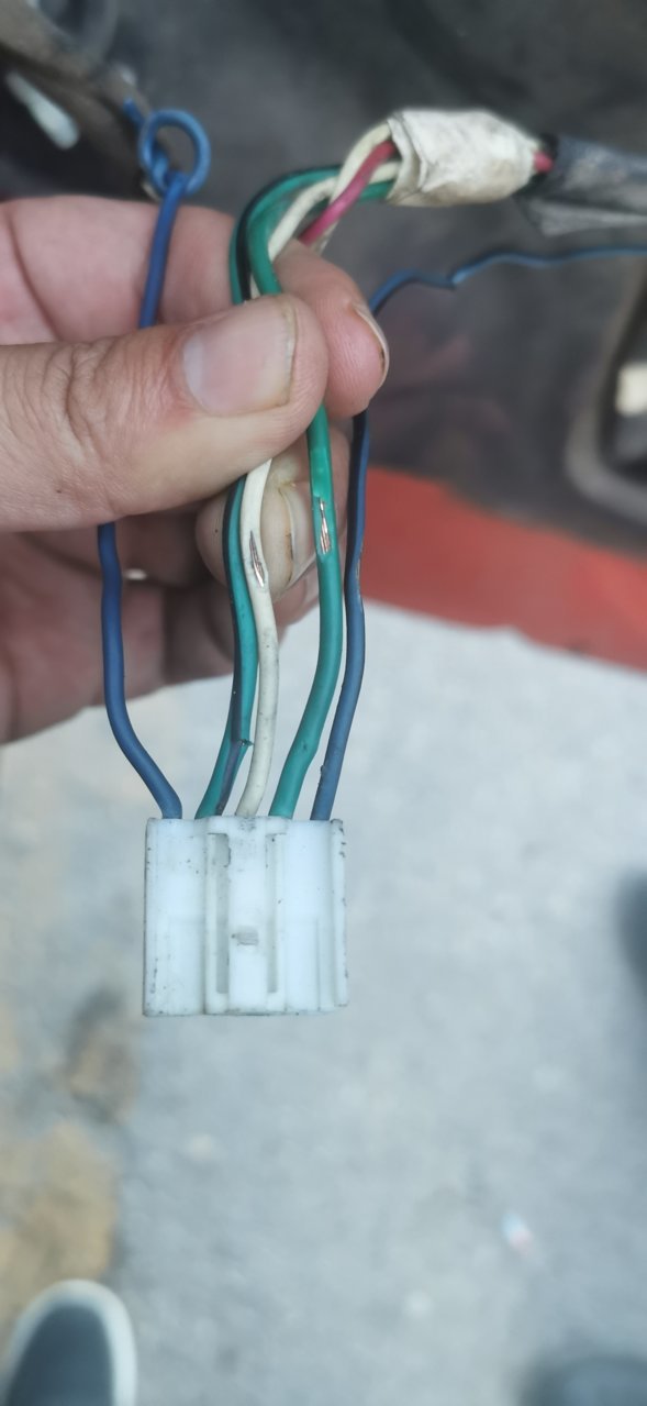

    hello everyone.
    Im looking for the connector that is in right rear door for the window. I have a tacoma 2010.
    Do you know where can i buy this?

    Replacing just because of the skinned wires?
    If it were mine I would just get some liquid insulation and paint it ( several thick coats ) and then tape it with some self fusing silicone rubber tape ( this tape is amazing ).

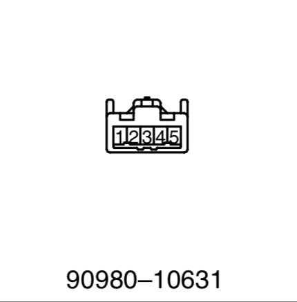

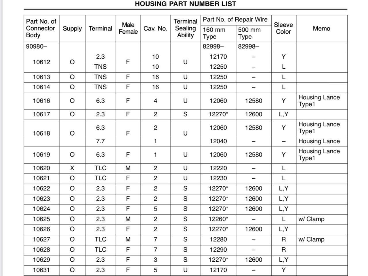

    That would be the easy way. (And I know what will likely be my next purchase at Lowe’s.
    I’m getting this?
    With out seeing the front, this is the best I can do74F39F1A-4B9C-4326-B05C-62643F2EEE67.jpgED25A034-0DCF-4B42-AE7C-1EFA5C877877.jpg

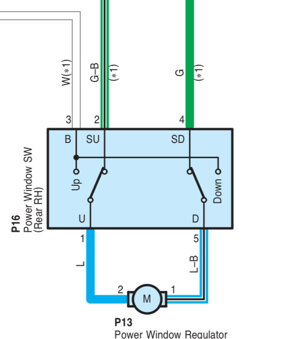

    @Jimmyh connector P16 on the power window diag.
    I believe that is the connector for the switch. Plugs into the switch.
    RR switch, my colors match?

    Yes you're correct I don't know what I was thinking. I was looking at BA1... o_O
    Thanks for the correction!:oops:

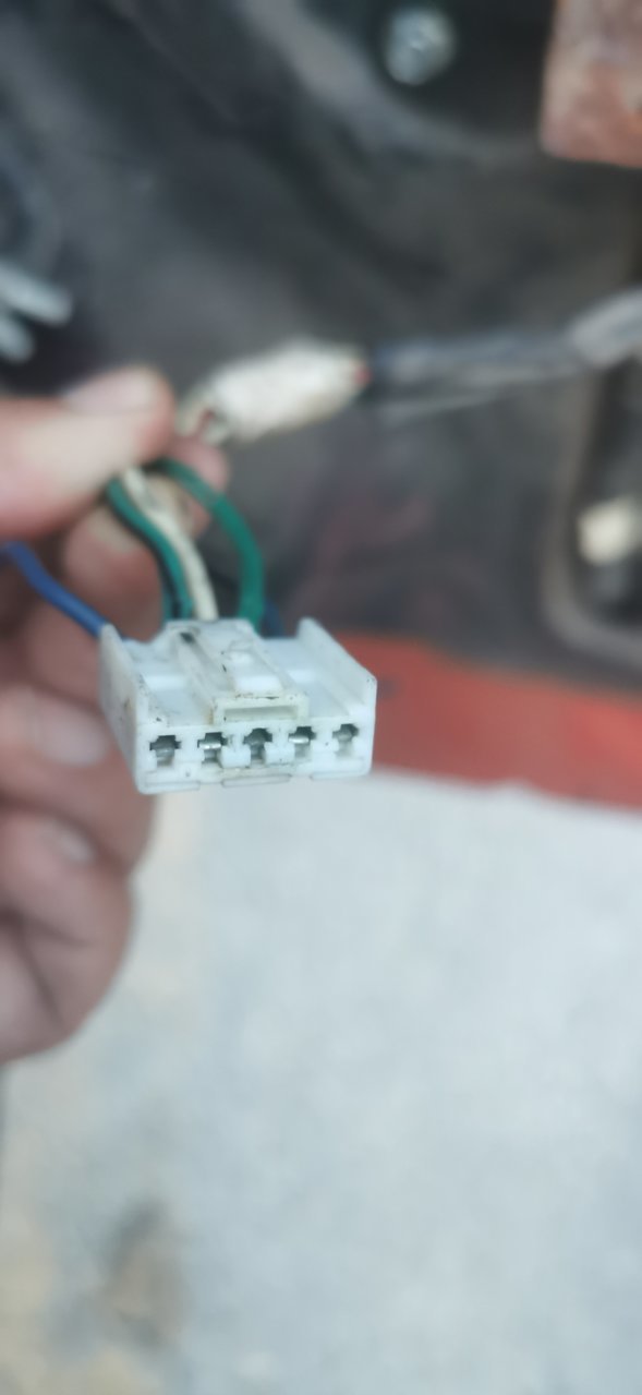

    i made this cut in the wires to verify the continuity. Also i check the motor and is working fine, that i see is that the connector in the terminal area has corrosion or water was inside and im thinking that this is the problem.
