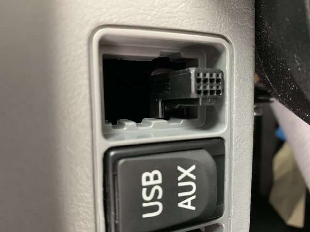

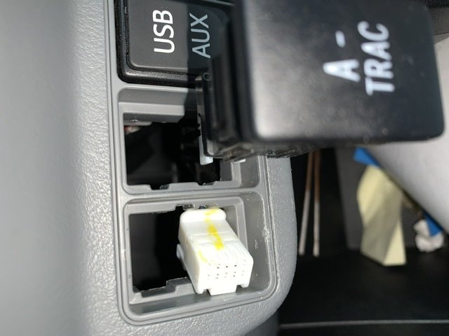

    Hello, I’ve spent the last hour or so searching for this answer but have been mostly unsuccessful. The only info I found was that Canadian Tacomas have heated seats and one connector is a possibility for that.
    I’ve attached pics of the connectors I’m referring to.
    The truck is a 2015 off road model.
    Thanks for any info.

    Yah if i had to guess you're prewired for heated seats. What year Tacoma?

    My 15 Off-road has the same plugs. They are for heated seat switches if the truck were optioned for it. Someone correct me if I'm wrong but I believe you could only get heated seats on the Limited model. While the dash harness appears to be pre-wired, there is no wiring to the seats themselves (even under the carpet, ive had mine out). Also the wiring to the heated seat relay in the engine bay fusebox is missing.

    I'll just ignore the plugs then and run a new wire for some driving lights I'm planning to install. It would be nice if that were a plug and play option though.
