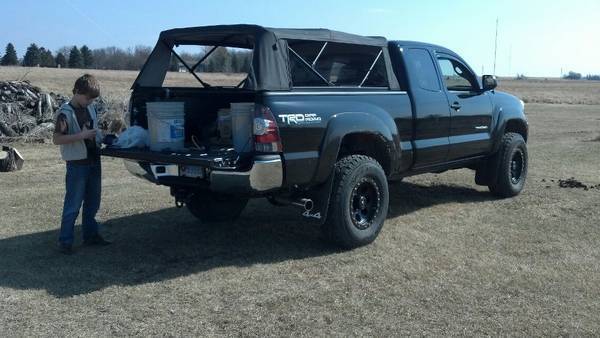

    What mine looked like with 265/75-16s:
