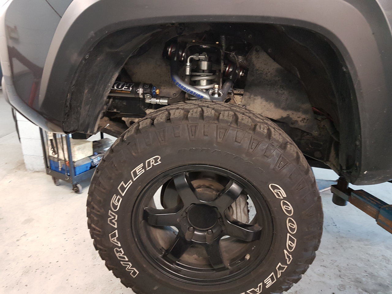

    Mine just went in got the truck back on friday so not sure yet how it will perform will know this coming weekend. But ride is harsh in the back. Not sure if its from the shocks not being set to softest or just cause I'm running Dakars with no weight in the back. Bed is completely empty so hard to tell.
    Even in the front its a little rough right now but thinking again a mix of springs still new and stiff and the shocks not being dialled in yet.
    I was reading through the warranty and maintenance parts for the fox stuff and it says every 50 000miles for rebuilds of all on road, 10 000miles if 50/50, but I'm nder the impression thats implying jumping it and doing baja racing like this suspenion is meant for. Not the rock crawling overlanding type trails I do a few times a month in the summer/fall months lol. Time will tell how long I get between rebuilds but hoping for at least 2 years between rebuilds if not more. I've had the truck for 10 months now and got about 17 000km on it so still nothing. Daily driving is short trips 20-30miles round trip. Figure I should be closer to the 50 000mile service since I wont be doing any sort of demanding trails in terms of fast movements really making the shocks work. I only went with them for the added wheel travel to get some more 'flex' out of the truck.
    But regardless from all I've heard about the Kings, they might be amazing when blasting through the desert but unless you've got the in come or tools to do rebuilds yourself they are way to expensive to maintain.
    I'm hoping I can dial in the fox a bit better for daily driving.
    I haven't had mine in long enough to say whether I'm happy or not. So far happy but time will tell.
    I will say the one big issue I am having with them is in the front...I can just barely get the wheel off the ground now cause I've got so much travel haha. Not really a problem for driving but making it a pain in the ass to do any sort of maintenance.

    On the lift still, all the droop from the front

    Sounds normal to me! Mine were stiff out of the box too. If anything, have your local offroad shop check the nitrogen pressure on your shocks and make sure they are all up to spec. Once you get over about a 1-2K miles they will soften up a bit and then you can get them dialed in for your setup. I ended up with no high speed dampening front or rear and 1 or 2 clicks of low speed dampening in the front with none in the rear.
