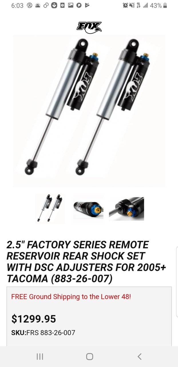

    Hello just got me my first fox rear saving for the fronts. Gonna get fronts with resi and Adjusters Screenshot_20190805-180324_Samsung Internet.jpg

    Was it good pick? How you guys like you're fox

    Poormans lift is bilstien 5100s. Add ome 888 coils for better ride and aal in the rear

    Love them! Had Fox for two years now and it's been great. Love the tunability and quality of the parts
