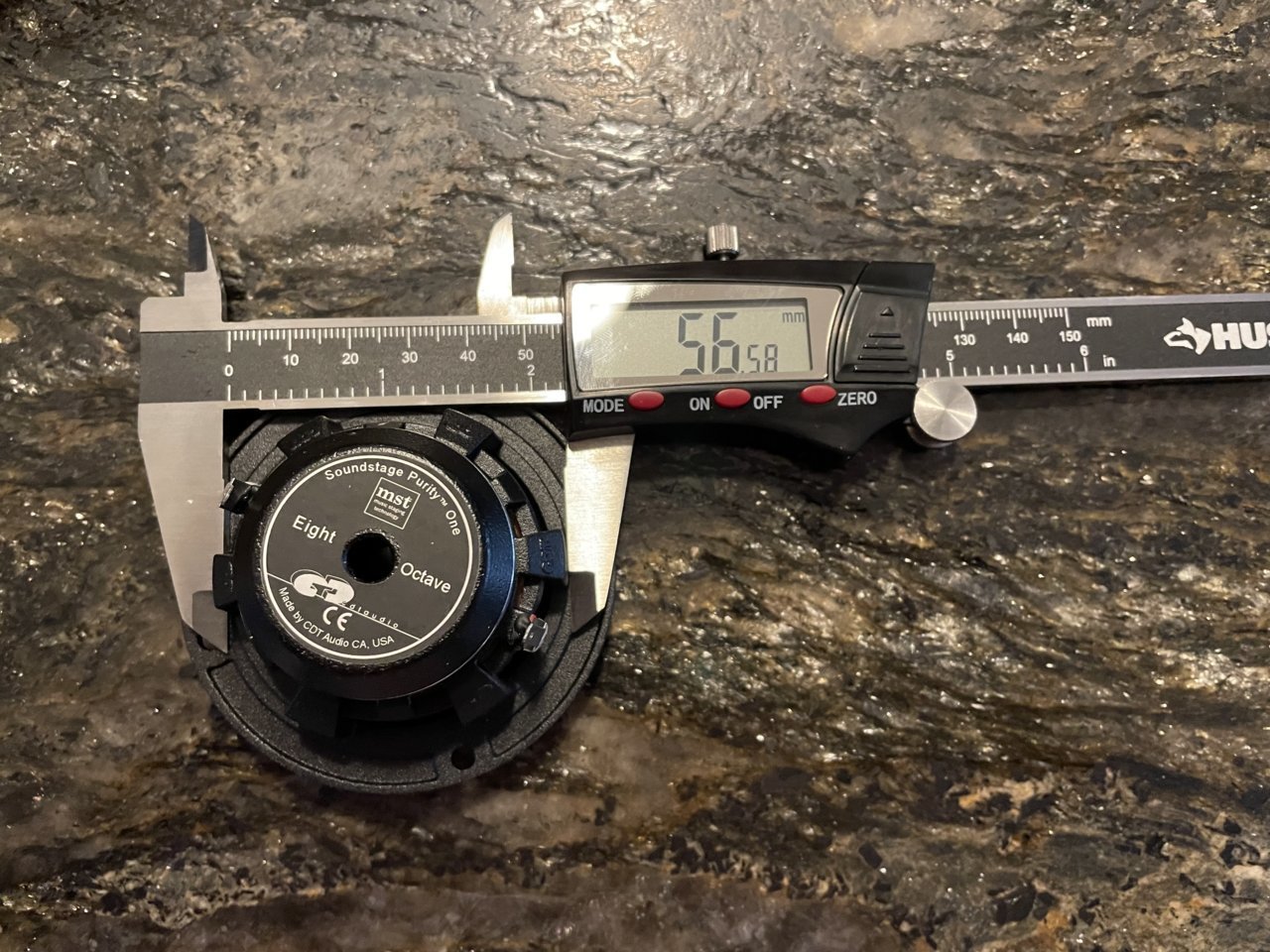

    Your going to want the Metra 82-4201 tweeter brackets unless you're going to try dremeling out the red wolf ones.
    https://www.crutchfield.com/S-pfpTtAJd6LI/p_120824201/Metra-82-4201-Tweeter-Mounting-Brackets.html
    The CDT unity 8.0 tweeters in the 4D kit are about 2.2" wide.

    does the metra drop in and screw holes match? I’d still have drill a hole a hole which is probably easier, but the red wolf looks sturdier? Maybe….

    I know, I know...Crutchfield's supposed to be delivering the goods this Wednesday. Once that and the deadening arrives the teardown and assembly begins. If I had to pick a timeline I'd say anytime between now and Memorial Day Weekend. :oldglory: I've always excelled in procrastinating. :ohsnap:
    The Red Wolf mount does look beefier. I'm just not sure there's enough circumference to accommodate the unity's. Not sure about the screw holes matching up on the Metra's. I've even thought about using some scrap plywood and making something. We'll see. :welder:
