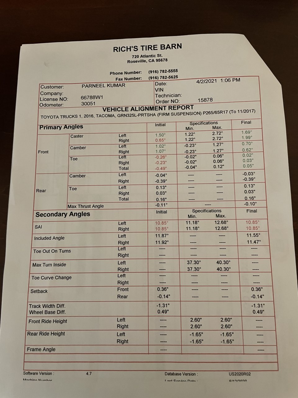

    No cutting of anything needed with my set up and I don’t just drive in a straight line.
    No vibration after added the tapered blocks. I didn’t add them initially because I wanted the front to settle before deciding on the size of the blocks. Before I added the blocks there was a slight vibration which I though was the tires not being balanced properly but it’s gone now that I’ve added the tapered blocks.
    Specs:
    2016 TRD Sport 2WD
    Eibach Stage 1 on the lowest clip
    Icon Rebound Satin Black 0 Offset 17x8.5
    Nitto Ridge Grapplers 285/70/17
    1.5 Inch Tapered Block in the rear.

    @iampraneel
    Whats the caster on your alignment? I'm 4.4/4.5 Caster on jba uca.
    I'm on very similar setup.
    6112/5160
    1.5" tapered block
    Icon Rebounds 17x8 0 offset .75" wheel spacers
    285/75/17

    I have the OEM UCA’s and here are my specs from the alignment.
    Sig Taco[QUOTED] likes this.
