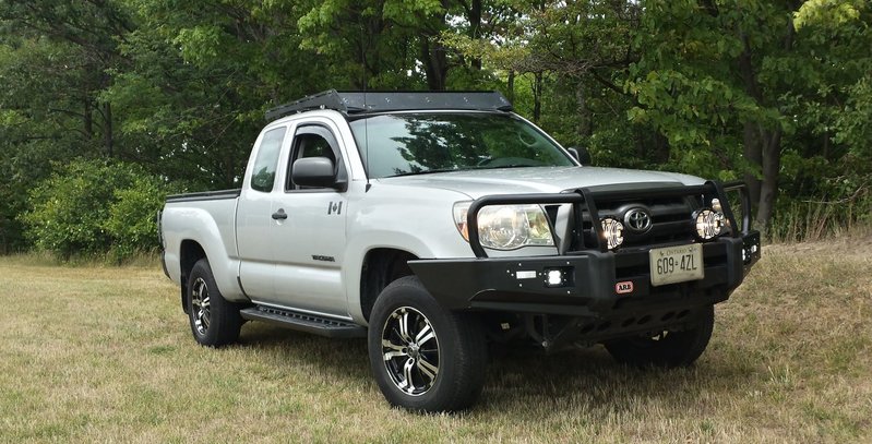

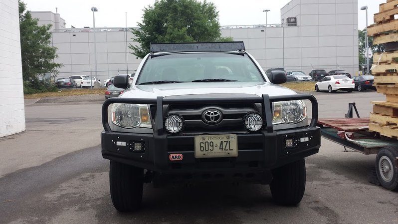

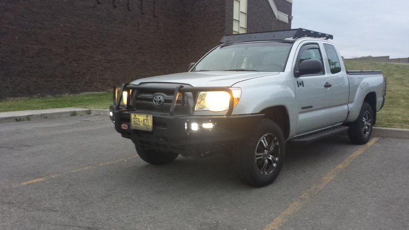

    Gone over the Top for a 5-lug..
    Yes, they were stupid expensive - i did get a discounted set, but that didn't really matter, since it was even more stupid expensive after paying in CDN $, and to import over the border.
    That said .. i didn't like the plastic buckets provided. Looked chintzy. These Labrak inserts are distinctive, and the 4 LED pods throw a wall of light, far forward.
    Yes, i've got armor hung onto a 5-lug, as commuting is something of a competitive contact-sport, some mornings.
    The ARB install was straight forward. My 5-lug is different obviously from the 6-lug. with the LCA/UCA's being different on the 5-lug, aftermarket parts aren't commonly available/discontinued now. I had to pretty much go to looking at Plan B, which was a 2.75" front / 1.75" rear shock mount spacer, and AAL in the rear. I run Bilstein 4600's on the front, and 5100's on the rear. My front end initially sacked by about 1/2", and has settled out to around 3/4" lower, ~25,000km's later. No bottoming out, no corner wobbles. I don't know if there are aftermarket coils (without a LT kit) for this version Tacoma - i've not really looked for them, as i don't think that i have the need for them - but i suspect that there are no such uprated coils specifically meant for this version with the OEM, definitively non-LT suspension.
    I obviously have no winch - there is no need for one with my little truck.

    Dual-color LED module - half in white, half in amber. When no turn signal active, it runs steady white on 1/2 of the module. When turn signal is activated, the other 1/2 of the LED module kicks in, flashing amber.

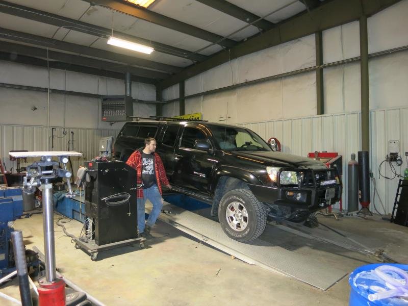

    The ARB on my first Tacoma took down a deer with no issues not long after I got it. No pictures because there wasn't much to see other than a banged up deer. It didn't fare quite as well against a Subaru and it took some damage. I walked away, the other driver didn't. I've posted this before but here's what an ARB looks like after impact. Corner impact, I was doing about 40mph, other driver's speed was calculated at about 50mph. Driver's side airbag deployed normally (no passenger side on the '95.5s). I'd already pulled the passenger side Hella 4000 before I took this picture that's why it's missing.
    Current Tacoma (shop techs in the pic, not me):
    Definitely upgrade the suspension, even if you don't add a winch.
