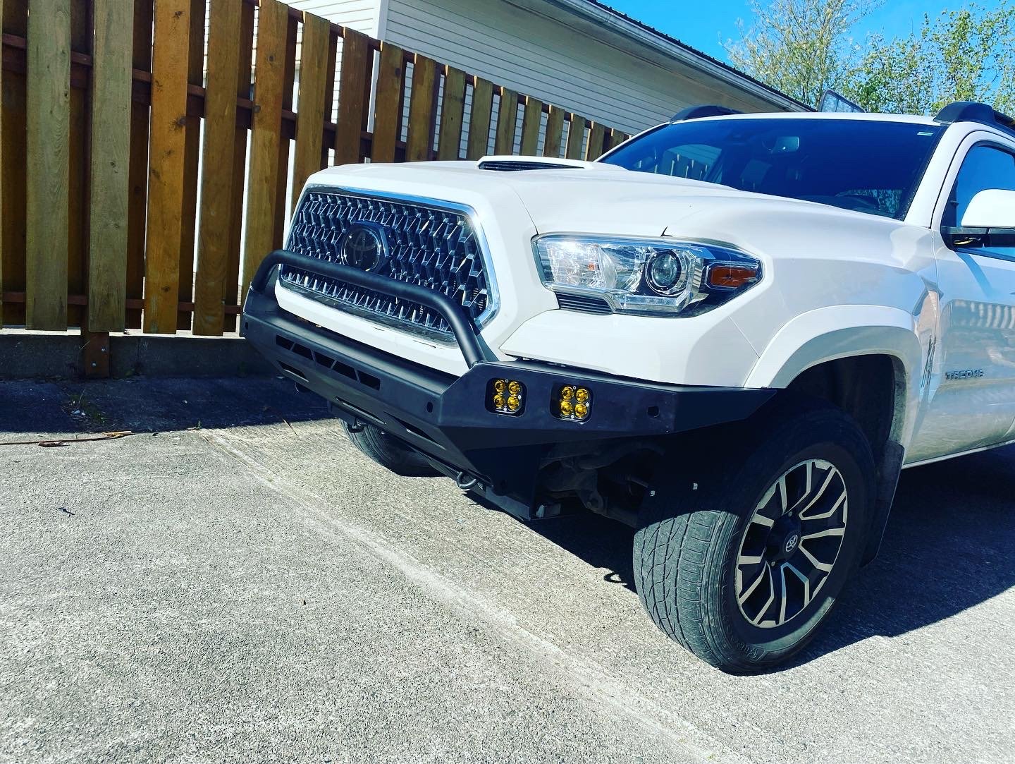

    I had stock bumper and fog lights removed and replaced with a high clearance metal bumper that came with 4 yellow ditch lights. The welder I paid to finish, assemble and install the bumper just put in a new switch and jumped it off the battery.
    I have been having power issues with my battery dying after only minutes of the interior lights on or turning the truck off but staying in the cab with the screen on. I suspect this power drain has something to do with the additional wiring of the after-market ditch lights and alternate connection (even when they are turned off) .
    Is there a way to find the existing factory fog lights wiring and connect this aftermarket light set up to the fog light switch on the steering column? I am fine to buy a conversion kit or whatever it takes if it means I don’t keep having my truck die on me. 2018 Taco sport manual

    I'd 1st make sure that a relay is being used to supply power to the lights.
    The lights should not have a switch that controls the 12 volts to the lights.
    The light switch is used to turn the power to the relay, then the relay sends power to the lights to make them turn on.
    I'd also unplug the new lights temporarily to see if you still have battery issues. This way you would know for sure if the wiring is bad.

    Yes. I bought an adapter on Amazon (probably one of the ones linked below) and wired the fogs in that way.
