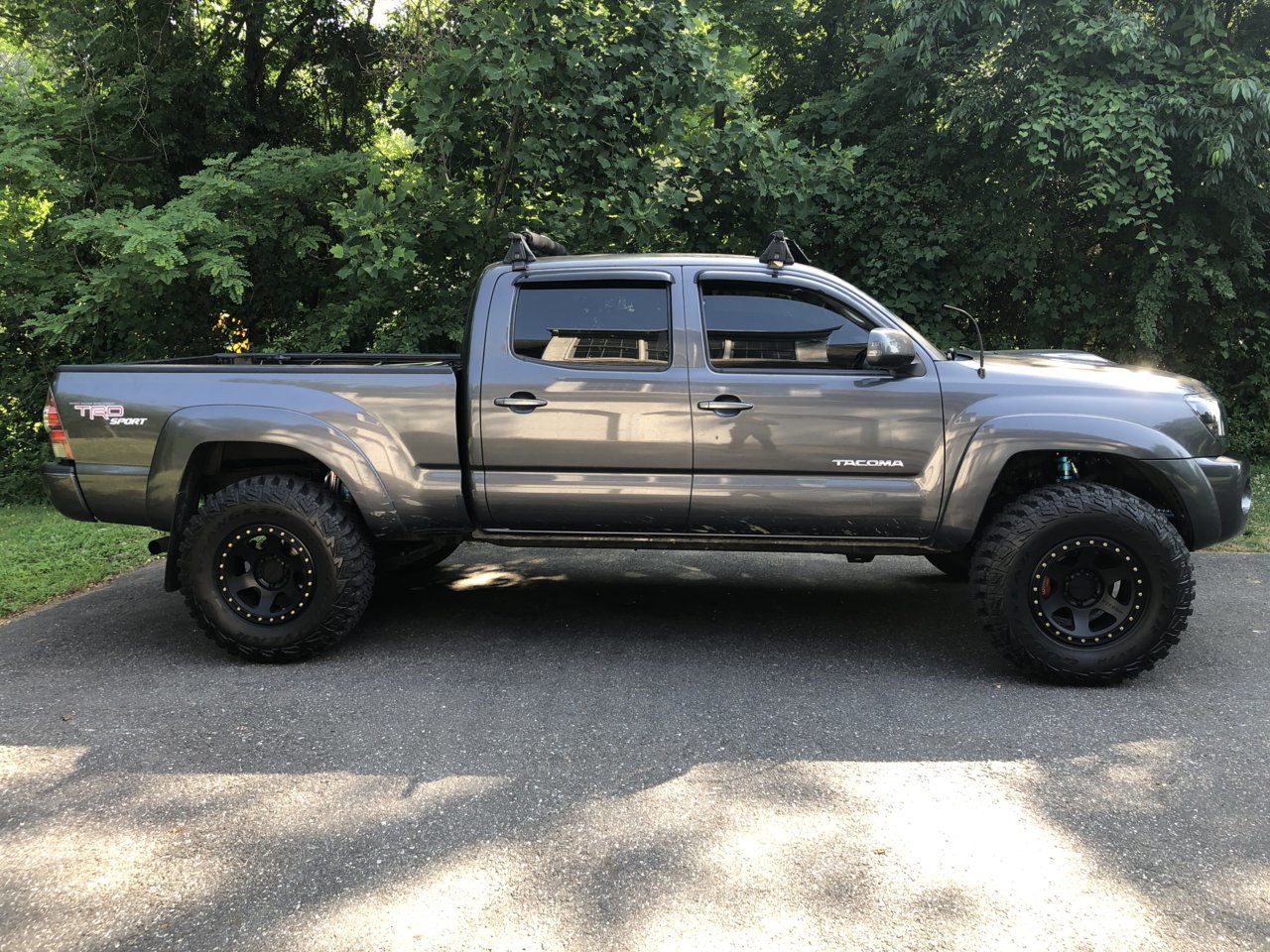

    What If I just TELL myself I have a long travel, but not do any of the mods. Will I still have those issues?

  16. Jun 4, 2020 at 12:50 PM
    #316
    WRDD Taco
    WRDD Taco Big Hobby Guy
    May 21, 2020
    #328766
    288
    Jake
    Delco, PA
    ‘11 TRD Sport DCLB LT 1G3 Moto Express
    TC Mid Travel +2, TC SUA, king shocks, Swamp Donkey/Rigid lighting, Mechman alt, SOS/Boztek armor, ATH Fab tiedown, full active JL/Audiofrog sound system, NOICO sound deadening EVERYWHERE. Up next: roof/bed rack + dry storage, skids, bumpers, fiberglass, power wire upgrade + frame grounds, LTO battery swap, air compressor, on board pressurized water, powered cooler, suspension seats, frame reinforcement, solid motor/trans mounts.
    New to TW but have had my Taco since new in 2010. Finally came around and got the 2 inch TC Expedition kit with a TC SUA kit with HD Deaver pack on King shocks. I think I’m going to have something like 12 inches up front and 12 in the rear. Would this be mid or long travel?
