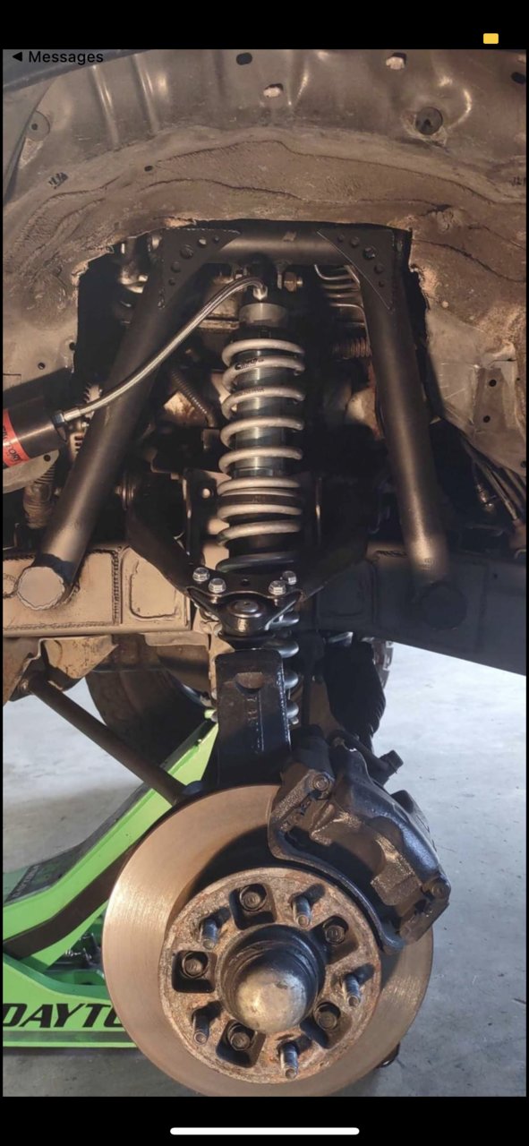

    Front coiliver conversion on 10’ fox reservoir
    Does anyone know if the all pro Tacoma long travel kit will work fine with a coiliver conversion on the front? It’s on 10’ fox reservoirs
  8. Nov 25, 2021 at 1:47 PM
    #328
    Dalandser
    Dalandser ¡Me Gustan Las Tacos-mas!
    Feb 19, 2015
    #149090
    17,674
    Anthony
    Downey
    08 PreRunner Regular Cab / 98 4x4 Extra Cab
    Empty Wallet Mod
    You mean 10" fox coilovers with an aftermarket shock hoop?
    Coilover conversion really is a term describing the converting of a separate coil spring and shock system into a coilover suspension, but Tacoma's already come with coilovers from the factory. If you're asking will an all-pro kit works with a 10" fox coilover, is there a drop bracket lift installed on the truck? Or rather than using stock or 8" coilovers are there already 10" coilovers installed on the truck pics would help.

    Nov 25, 2021
    #383016
    3
    97’ Tacoma 2wd
  10. Nov 27, 2021 at 9:41 PM
    #330
    Dalandser
    Feb 19, 2015
    #149090
    17,674
    Anthony
    Downey
    Empty Wallet Mod
