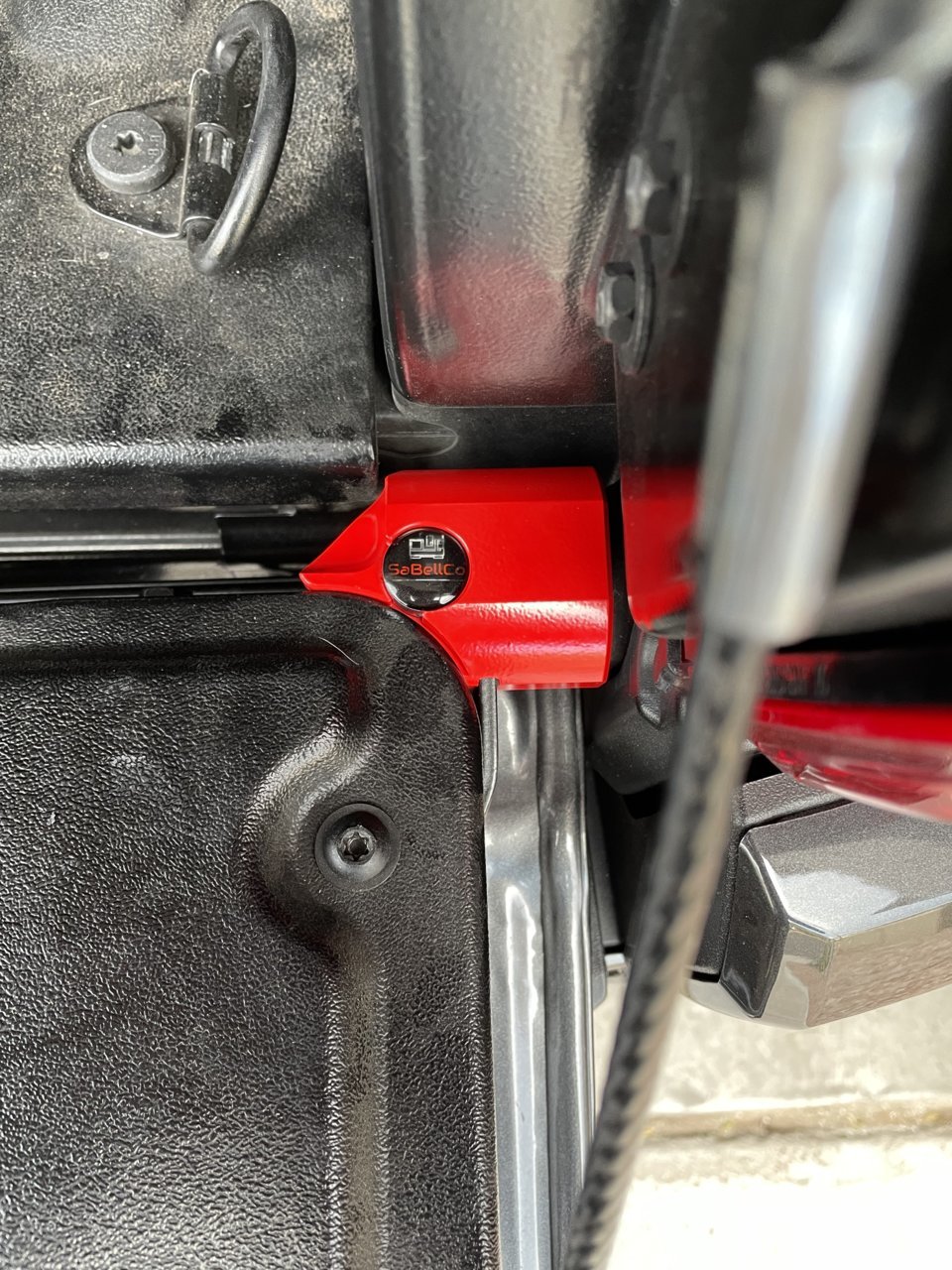

    Just checked. No rubbing on ours either. If you cut the little plastic pin, it’s seated properly, there’s no body damage and it still rubs, agreed, I’d contact them or just get a replacement.
    Since it’s powder coated I probably wouldn’t grind it. Breaking the surface could lead to rust or other problems.

    He offered to replace it free of charge. I just took off about 1/16-1/8 off the corner of the composite. I don't really think it had to do with sabellco but it's good for them to know as he can adjust the design 1mm if it continues to be an issue with 2023's. Toyota's robot making the beds might be spending to much time on tiktok while at work not paying attention.

    For the rubbing on the SaBellCo Lock, if you loosen the bolts on the tailgate skin and center the holes in the liner you will not have to trim anything.

    I'm late to the party. I had the same issue. A dremel tool and small grinder wheel and just a touch off the plastic bed liner did the trick..
