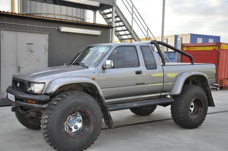

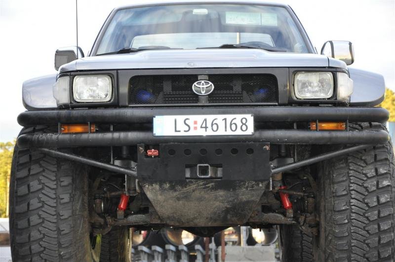

    Different truck and also MUCH MUCH more than I want to do, but that guys inspired me very much with that setup. Awsome set-up that makes me want to think differently.
    Notice how straight are the control arms angle to the ground.

    That is cool - no doubt.
    I still bet he can no longer turn that thing lock-to-lock though.
    EDIT - also, that size tires on a first-gen - it's gotta be really easy for that thing to break CVs out on the trail.

    That guy is running 42" w/3" bl. As I said, it just to tell you what inspired me because I know my set-up won't be close ot that.

    Also notice how his CV's are pointed up... :confused:
    (Also notice he is running a turbo...)

    They make them like this in Iceland, hence the turbo diesel Hilux, there's a company called Arctic Trucks (I think) that makes them, they probably have info you could steal from their website or by email maybe. What I heard is they have almost zero suspension as the giant tires with a super low tire pressure make up for it. Made for cruising across frozen snow and ice. Super high offset rims and wheel spacers and fender flares I would guess.
