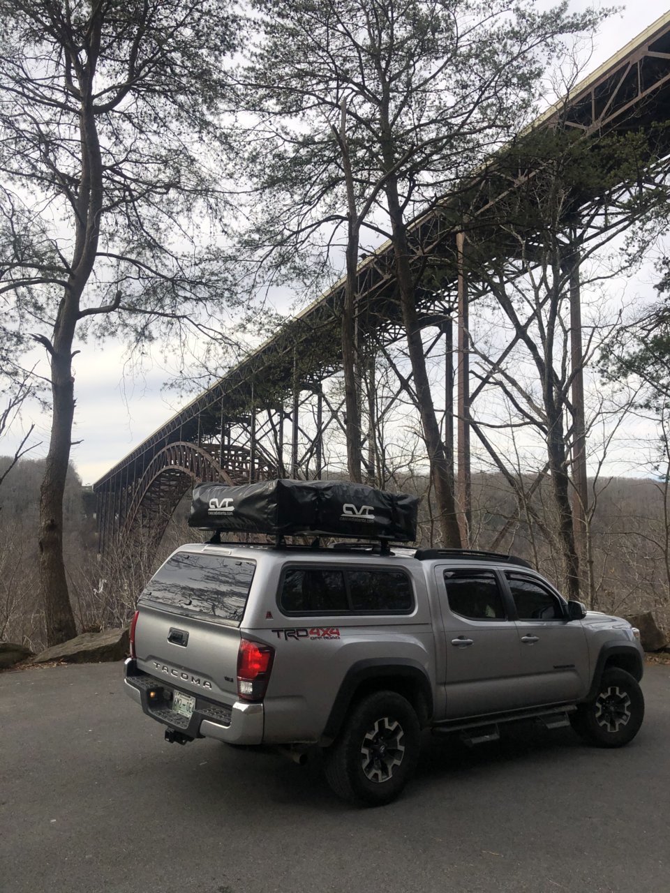

    Got a 19 TRD off road and recently put in a Decked system, camper top, and a rooftop tent. I’ll be receiving my gofastcamper in November 2020 so I currently have some time...
    I want to build out my Tacoma to comfortably haul the 200lb Decked system, 250 lb go fast camper and 100-250 lbs of extra gear and equipment in and out of the drawers.
    I typically travel solo but do frequently have another person with me and all their crap. I’m looking to A) comfortably carry 600-700lbs easily without all the sag I currently have on they stock off road kit I currently have b) lift the truck 2-3 inches - tires, lift kit? New suspension??? Also - I should add that I have the predator tube nerf bars which honestly get in the way but may be beneficial with a lift?
    most of my driving is on pavement for work but on the weekends frequently rock climb, whitewater kayak, obviously camp, and drive forest service roads, and some off roading (little to zero rock crawling). Think Southeast mank - thick forests, ruts, small rock gardens. Nothing like big rock crawling. Looking for the ultimate utility Tacoma but nothing too too excessive as I like the clean look of my current set up

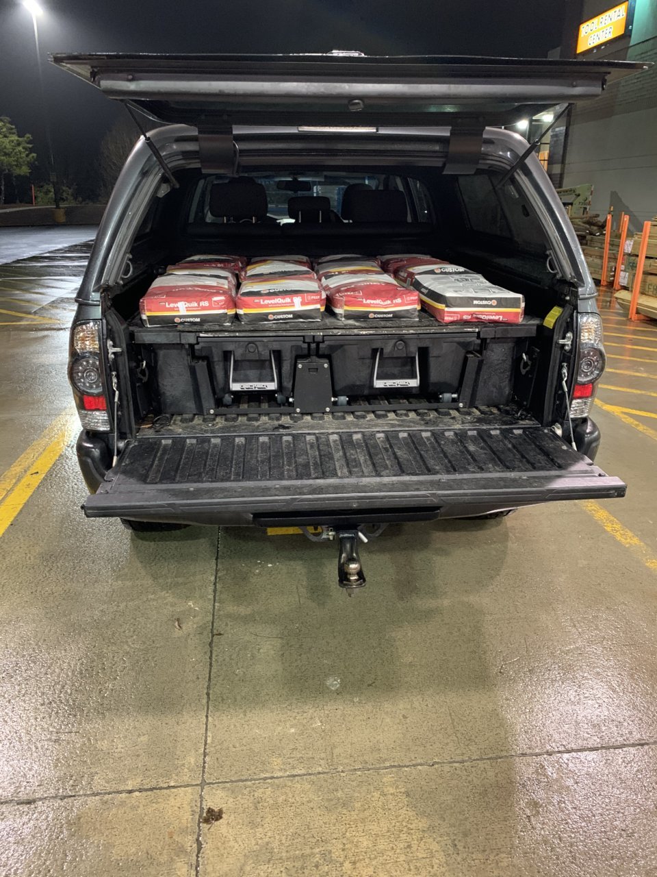

    I’d suggest Icon RXT leafs with option 3. I have them and setup on option 2 right now, also a Decked system and a fiberglass cap. This weekend hauled 12x50# (600#) bags in the back and still had a couple inches before the bump stops. Ride was fantastic considering the weight.
