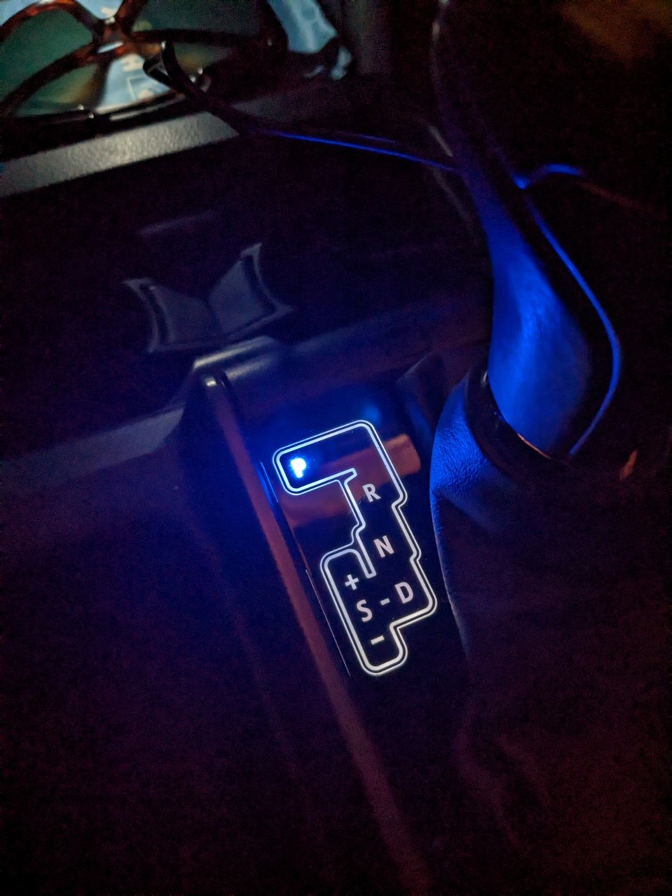

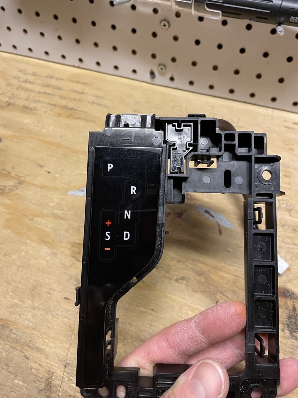

    I had enough of being distracted at night by the super bright D (drive) gear indicator in the console so I removed the console then I unplugged and unscrewed the indicator and shifter boot assembly. After bringing the assembly into the house I set about opening the indicator.

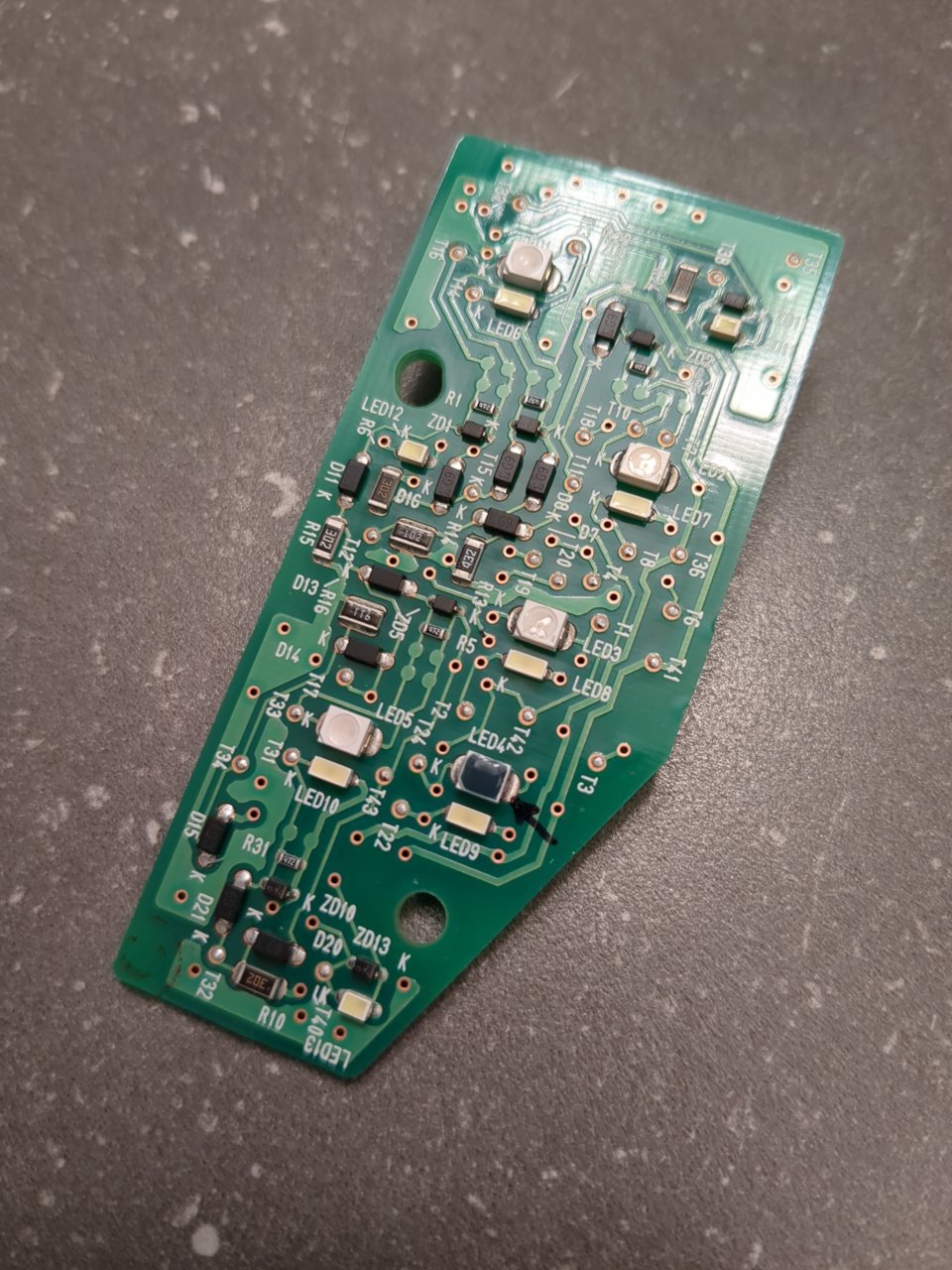

    I accessed the solid state chip board and located the LEDs. Then I put the smallest drop of my wife's dark blue nail polish on the LED behind the D reducing the brightness to a dim glow.
    I'm super happy with the results and I can now drive at night without perpetually having to cover the indicator with my hand.

    The technically correct way would have been to desolder the resistor with a hot air gun and put a resistor of a higher value in.

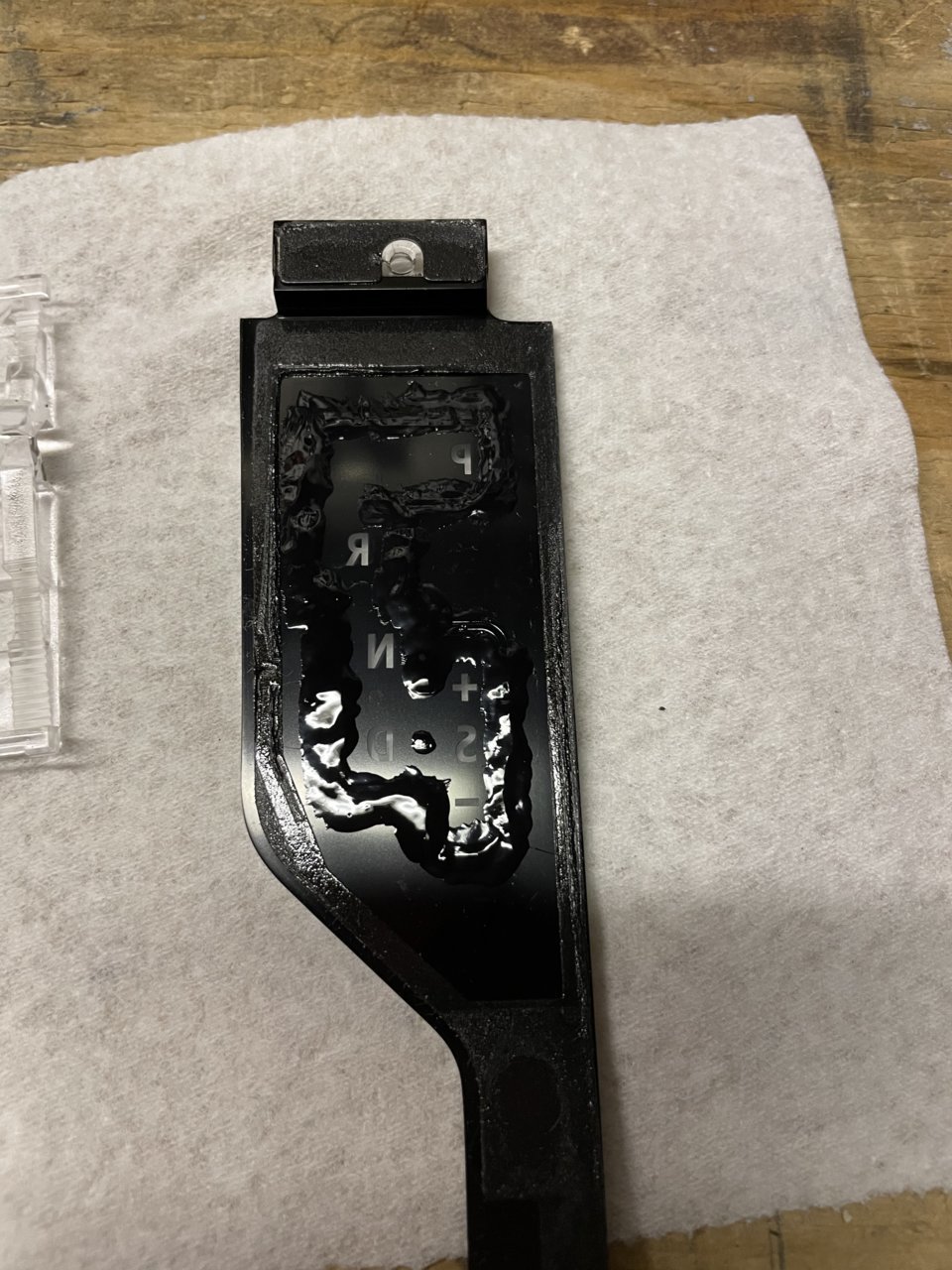

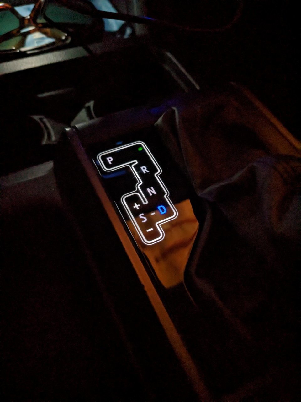

    I tackled this mod a couple weeks ago. Came out awesome. Used nail polish and covers the leds as well with a dab of nail polish and tiny tube 3m electrical tape pieces.

    Here’s a night pic

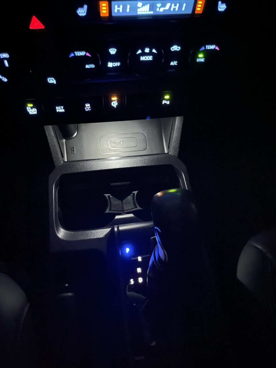

    Two layers of tint over the shift display panel. one layer on the JBL display way too bright too. Ski
