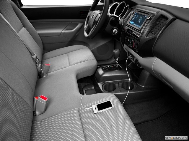

    Some reg cabs have factory bench seats. They have a small center console below the dash surrounding the shifter either a 5 speed or auto. I'd imagine there's are a few in junk yards by now. The seat back is not covered though. You would probably also need to buy new carpet. That might be a pain because all of the carpet for the extended cabs might come cut out for the console.

    I have a bench seat i removed from my regular cab that is almost new condition and I can't even give it away (I have tried locally).
    Correct that the back isn't covered with seat fabric (it has a black felt cover) but it is an easy fix if one dropped the bench seat into an access or double cab. The bolt pattern is the same in the floor for both bucket and bench but you will spend more time on airbag, seat belt, and other SRS related wiring more than anything else related.
