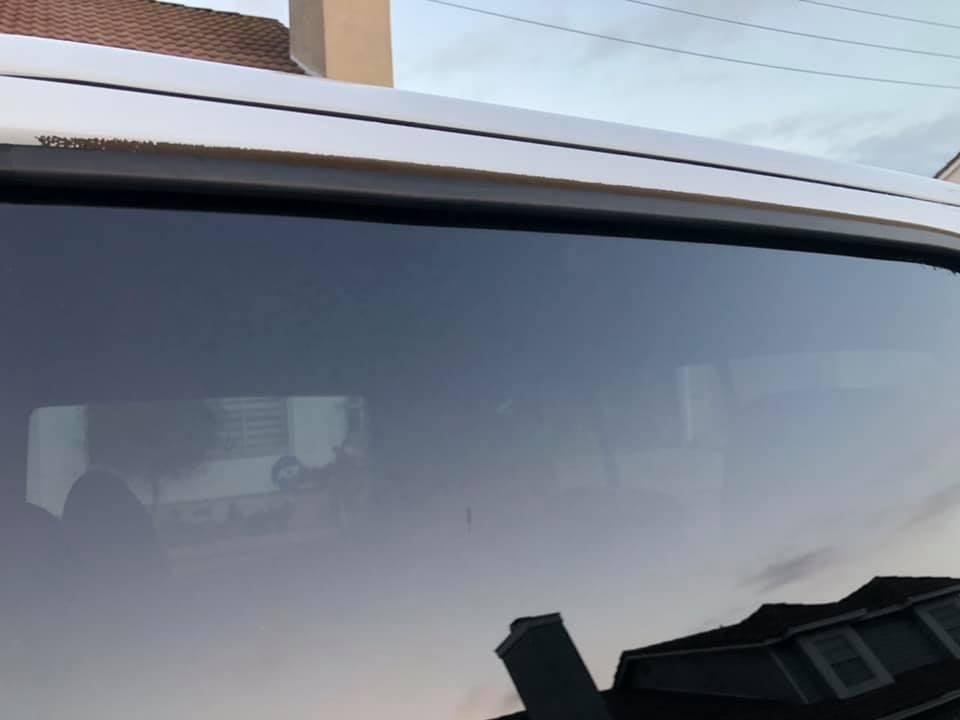

    Where i see a lot of the peeling happening with others is at the C pillar next to the rear passenger windows.

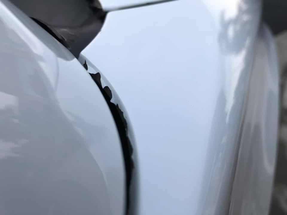

    I didn’t originally notice mine there, but have since noticed mine peeling there as well. In the channel where the hood meets the fender, on the fender side.

    Yeap. Mine came right off in strips over a one month period.

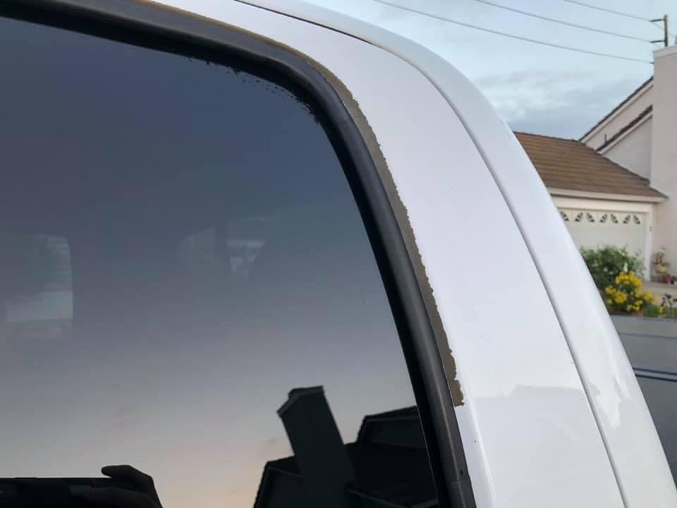

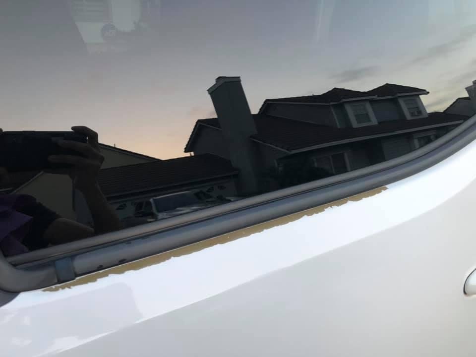

    Saw a guy posted this on Facebook yesterday on a 2017 with 123,000 miles based in AZ/CA. Seems to be happening a lot to the 2017's, not sure if it's just pure age and the others years haven't hit the same point yet, or if it's a problem for that specific model year.
    Edit: Not sure if it's a factor, but he said his was manufactured at the Mexico plant.
    shakerhood likes this.
  14. Oct 23, 2020 at 10:52 AM
    #34
    jowybyo
    jowybyo Well-Known Member
    Nov 19, 2013

    Thats what my fenders looked like. Shitty paint.
