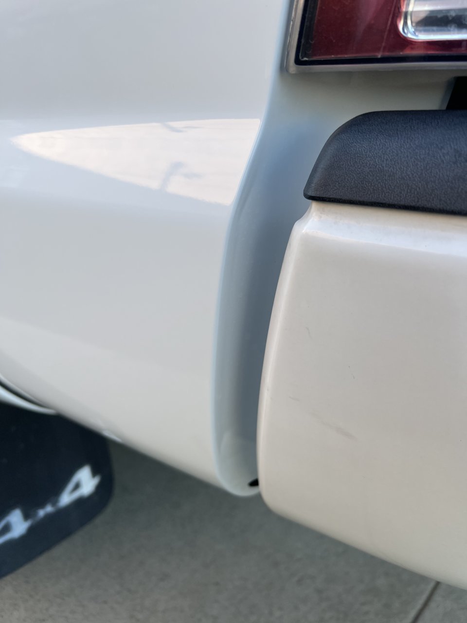

  1. Mar 12, 2023 at 2:04 PM
    #421
    OI_taco
    OI_taco Well-Known and liked Member
    Nov 5, 2018
    #271807
    31
    WA
    Super White DCSBTRDOR
    Radiator cap AC drain mod Debadged Snugtop
  2. Mar 12, 2023 at 5:57 PM
    #422
    Canadian Caber
    Canadian Caber R.I.P Layne Staley 67-2002
    Oct 28, 2020
    #345206
    2,667
    Les
    B.C. Canada, eh
    2020 TRD Sport DCLB 4X4 Super White
    Damn. What year and what plant was it made at? First number in Vin is location. 5-Texas. 3-Mexico.
  3. Mar 12, 2023 at 6:06 PM
    #423
    OI_taco
    Nov 5, 2018
    #271807
    31
    WA
    2018 from the mexico plant. I didn't get any love from the dealer which wasn't unexpected.

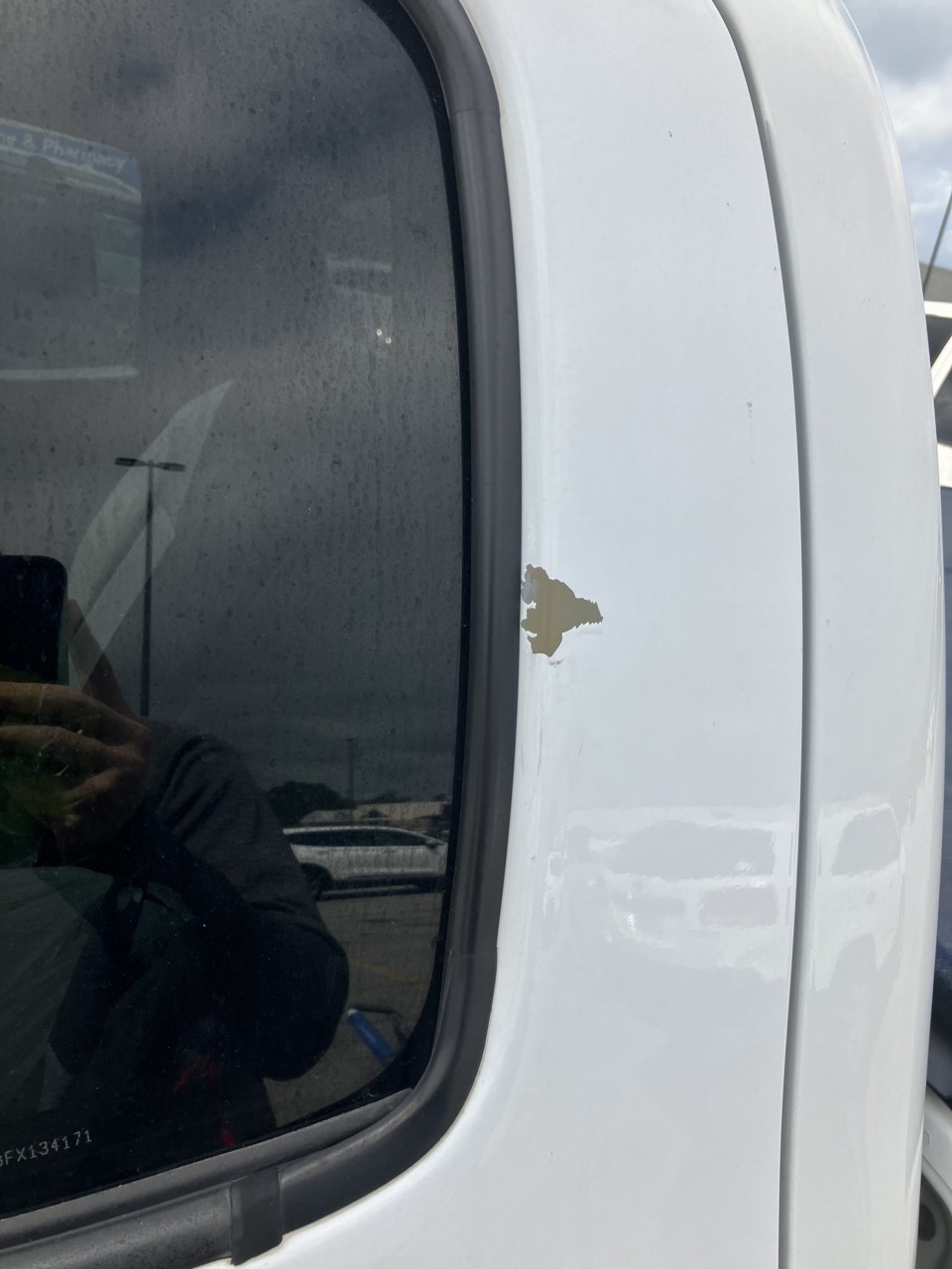

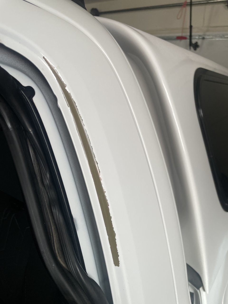

  6. Mar 24, 2023 at 5:51 PM
    #426
    TVphotog97
    TVphotog97 Well-Known Member
    Aug 19, 2019
    #302654
    186
    Codie
    Upstate South Carolina
    2019 White Tacoma SR5

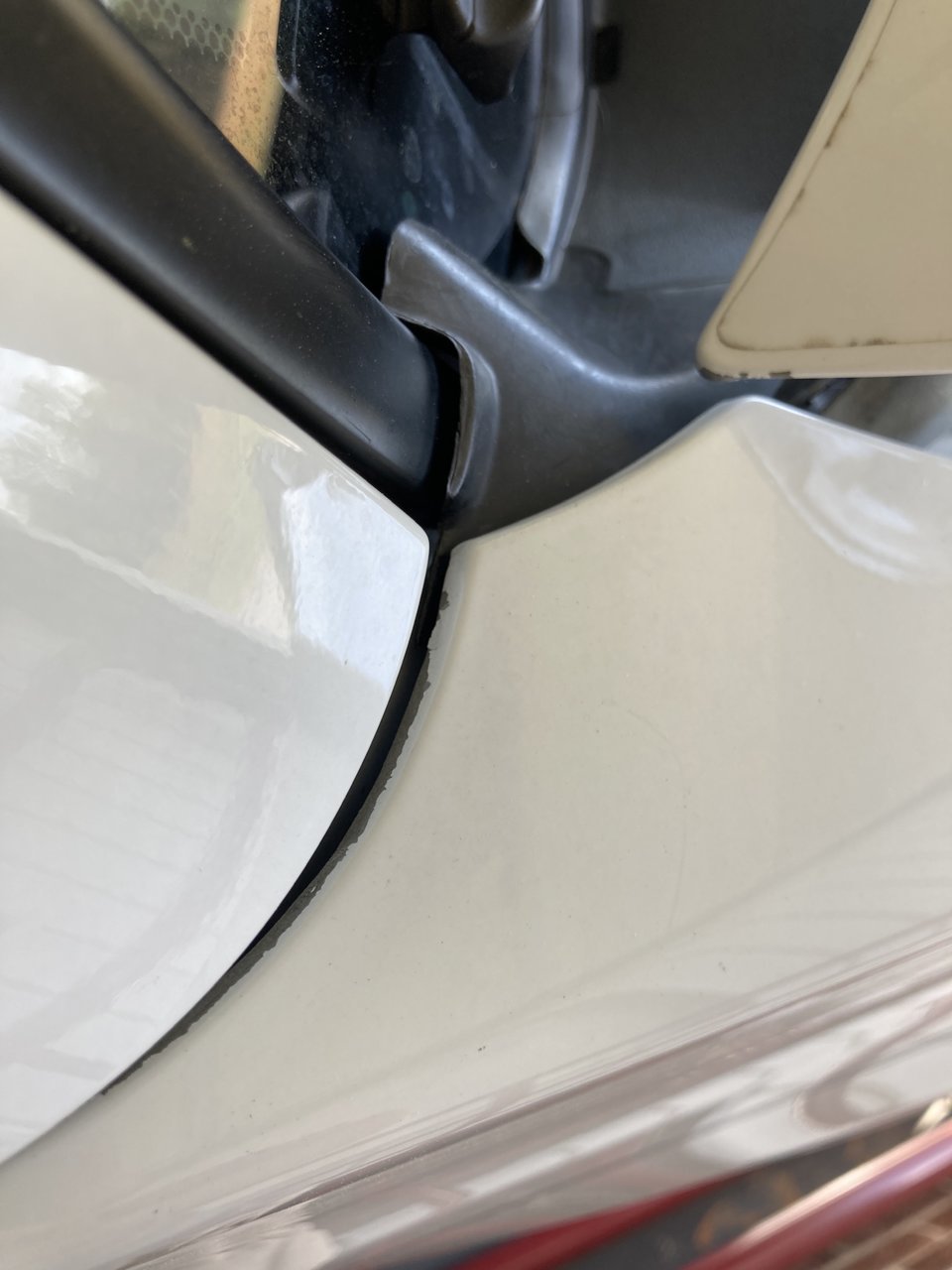

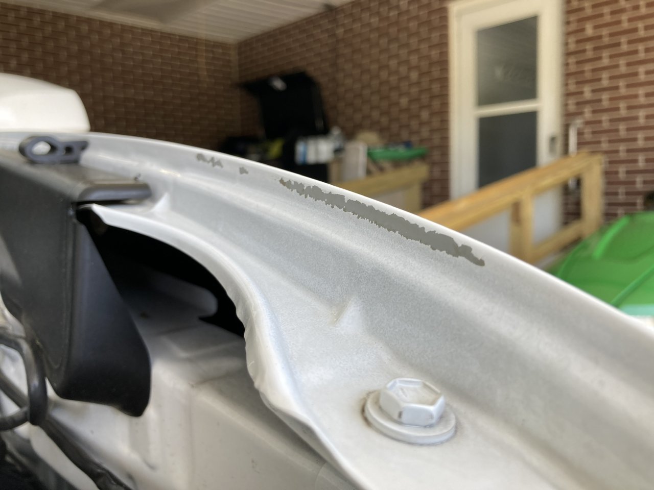

    Since I noticed the first bit of paint peeling nearly two months ago, I’ve been keeping watch for it to spread. Unfortunately it has. So far, mine seems to be at inconspicuous spots. But of course that’s subject to change. Right now it’s at the bottom of the A pillar on both sides where it meets the fender/door. Also along the fender at the hood edge, and a couple other random spots - if that makes sense. Really a shame Toyota won’t give us Tacoma owners any help.
    765A094E-F8D0-4CD0-B36D-9B3E5A65582B.jpg 2982B021-6F08-4F89-B653-89FA2BD0F8CB.jpg 44CC8B7A-57C5-48C2-95B7-21CD58F00C42.jpg
    medicweed likes this.
  7. Mar 24, 2023 at 7:00 PM
    #427
    Canadian Caber
    Oct 28, 2020
    #345206
    2,667
    Les
    B.C. Canada, eh
    Unfortunately those are very common areas to fail first.

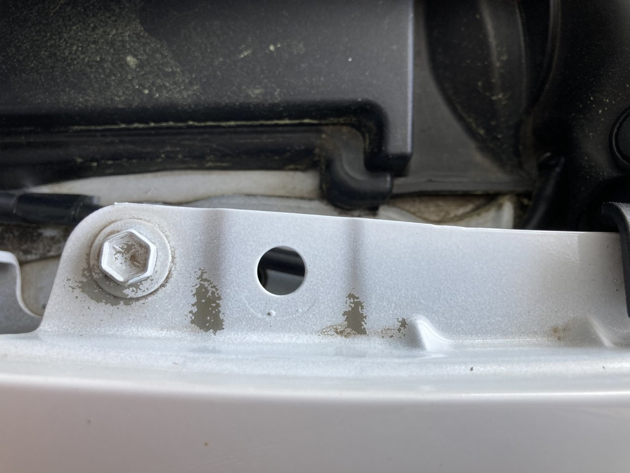

  8. Mar 24, 2023 at 7:15 PM
    #428
    Sugar Silva
    Sugar Silva Well-Known Member
    Mar 21, 2014
    #125848
    1,446
    Dave
    San Diego, CA
    16 Toyota Land Cruiser
    Kings Sliders TRD Rock Warrior Wheels Tint
    Just found this on my 2015. Truck doesn’t have a single scratch or dent and has been sealed up regularly since day one. Quotes so far are $500 no warranty or $1300 “the right way”
    At first I was going to do it the right way with a warranty, but what’s the point if the problems are going to keep showing up.
    may be making a short drive to a paint shop in Mexico in the next year or two

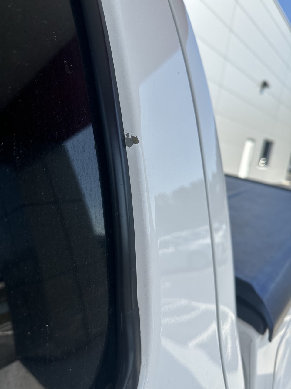

  13. Mar 31, 2023 at 6:05 PM
    #433
    Hook78
    Hook78 Well-Known Member
    Dec 3, 2017
    #237571
    6,855
    Eastern NC
    2015 DCSB TRD OR
    Bilstein 6112/5160 Icon RXT
    Discovered this small area of flaking in a common area a month or two ago and just finally got around to taking it in to the dealer. They took pictures, documented the visit, and said I would have to call a Toyota directly. Did that, Toyota said sorry, there’s no service campaign covering this issue. I had them document and provide a case number so I could decide what to do next. I was advised to get a quote from the dealer and Toyota “may” help out with the cost but no guarantee.

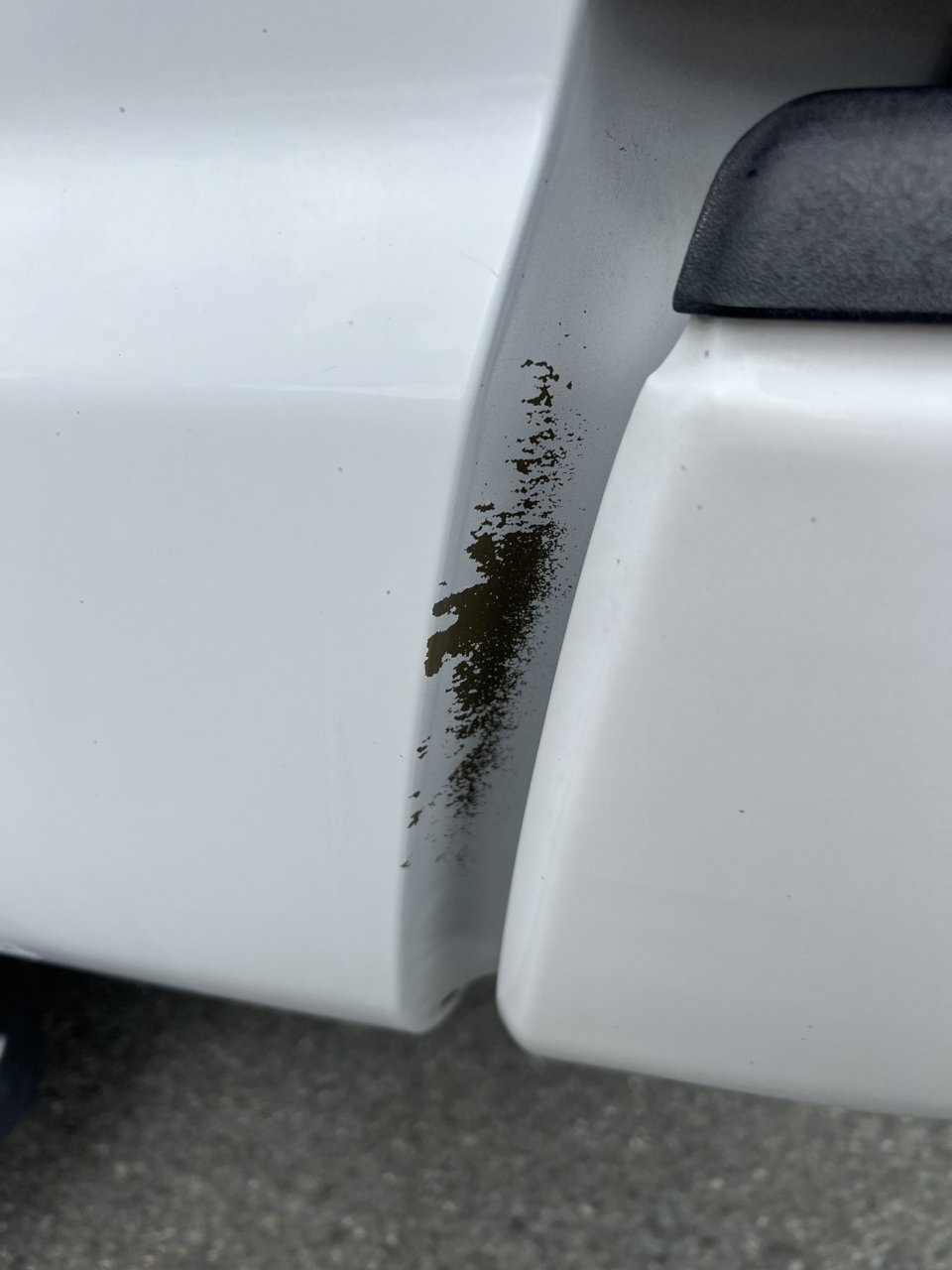

  15. Apr 6, 2023 at 6:36 PM
    #435
    Hook78
    Dec 3, 2017
    #237571
    6,855
    Eastern NC
    2015 DCSB TRD OR
    This has now become this, just from highway speed wind:
    Toyota quote for full door repaint: $2300
    Local shop: $1300
  16. Apr 6, 2023 at 7:07 PM
    #436
    Sierrahunter
    Sierrahunter Well-Known Member
    Dec 5, 2021
    #383862
    248
    2022 SR5 Double Cab Long Bed 4x4
    Sorry to see this. It’s just going to get worse elsewhere on the truck. I’d wait to repair until you have a better understanding of where else your paint will fail.
